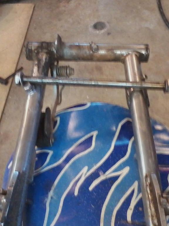

bondy Posted May 3, 2015 Report Share Posted May 3, 2015 (edited) scot Lary just just as i thought the Rear Engine mount should be tight once the Axle as been torqued down. Edited May 3, 2015 by bondy Quote Link to comment Share on other sites More sharing options...
lbhbul Posted May 3, 2015 Report Share Posted May 3, 2015 Bondy, you got it, just make sure the swing arm moves without moving the motor mount. When you get it assembled a shot of grease on each side & no more tearing it down ever. Don't forget to grease the bolt. Larry Quote Link to comment Share on other sites More sharing options...
bondy Posted May 3, 2015 Report Share Posted May 3, 2015 the S/Arm has grease nipples i use bearing grease that has a good wash out resistance. also i will have a bunch off parts zinc plated and titanium Engine bolts. 1 Quote Link to comment Share on other sites More sharing options...
bullylover Posted May 4, 2015 Report Share Posted May 4, 2015 Bondy, don`t forget that the grease nipples only grease in between the inner and outer bushes. It does not lubricate the swingarm axle at all. So that means unless you pull the axle out and grease it it will get stuck onto the steel inner bush. Graham. 1 Quote Link to comment Share on other sites More sharing options...
bondy Posted May 4, 2015 Report Share Posted May 4, 2015 Am having mine zinc plated so it will never rust Quote Link to comment Share on other sites More sharing options...
lbhbul Posted May 4, 2015 Report Share Posted May 4, 2015 (edited) Bondy, Please take Grahams' advice, GREASE THE AXEL. Zinc plating won't stop rust very long if at all!! This from personal M92 original (my) assembly many years ago. Tear down recent. (reweld kick stand). Had a m199 several years ago w/ original chrome plated aluminum bearings that required lots of heat & beat to get it out. Larry Edited May 4, 2015 by lbhbul 1 Quote Link to comment Share on other sites More sharing options...
smelling123 Posted May 4, 2015 Report Share Posted May 4, 2015 Titanium wouldn't rust 2 Quote Link to comment Share on other sites More sharing options...
bondy Posted May 4, 2015 Report Share Posted May 4, 2015 i always load plenty grease on all moving parts goes with out saying. i may also have 1 made from titanium not cheap tho we will see i ham having titanium Engine bolts alot cheaper will keep you posted. 1 Quote Link to comment Share on other sites More sharing options...

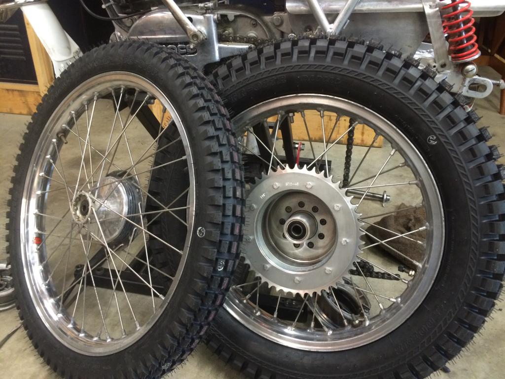

saw miller Posted May 4, 2015 Report Share Posted May 4, 2015 The rat is getting a new pair of shoes today. Irc tr011 Just like Larry said. "They feel a lot like bubble gum but they smell better" 4 Quote Link to comment Share on other sites More sharing options...
