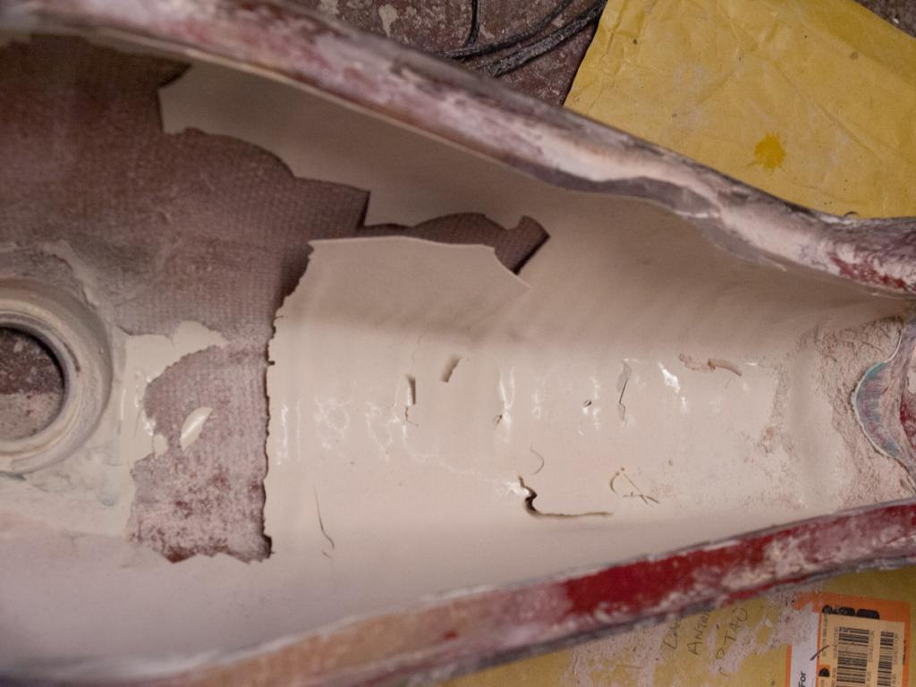

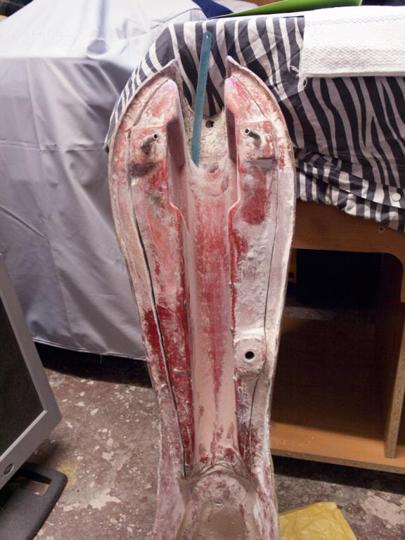

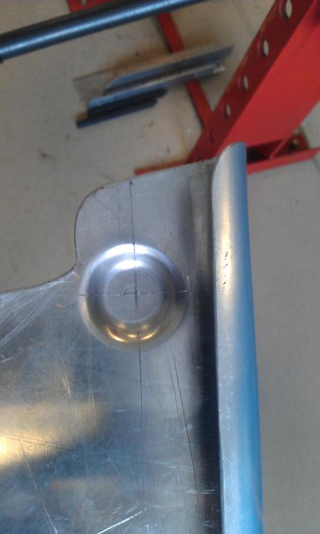

trailie Posted June 24, 2015 Report Share Posted June 24, 2015 Well I finished fabricating the chainguard with a nice dimple and bracket, but I've also took the plunge and cut open my tank. Anyone made similar repairs? http://ralphsbultaco.blogspot.co.uk 4 Quote Link to comment Share on other sites More sharing options...

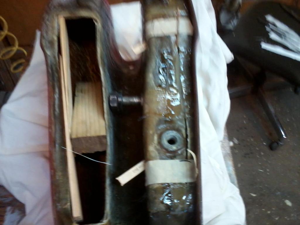

lbhbul Posted June 24, 2015 Report Share Posted June 24, 2015 (edited) It is quite an adventure to open a tank , and it also takes a certain amount of nerve, also kind of scary. I have done so on more occasions than I wanted to, but such is life with old machinery. By the way the chain guard looks really good, I have always wimped out & paid for the SM, good work. Mod 49 tank putting back can be a bother!! Naturally this was a painted tank that I messed up the first go around All good now Hope this helps Larry Edited December 26, 2015 by lbhbul 3 Quote Link to comment Share on other sites More sharing options...
trailie Posted June 24, 2015 Report Share Posted June 24, 2015 I had thought of cutting the two big slots like you did but the boat repair man reckoned it wouldn't make any difference just cutting the thing in two bits. Yours turned out looking really good Larry. Did you use anything inside it again afterwards. Brian was telling me he has a resin that he uses in chemical tanks that's resistant to acids, but ethanol's not really an acid, so I might go with whatever is currently the best - caswell maybe Quote Link to comment Share on other sites More sharing options...

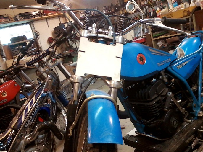

lbhbul Posted June 24, 2015 Report Share Posted June 24, 2015 Yes I did use a product that is available here but maybe not where you are, I have a friend who uses Caswell, to good end. The whole thing depends on how clean you get the tank prior to lining that makes the job good or not. I do not use any Ethanol, however modern fuel, and polyester resin, NOT GOOD!!! But back to my Blue girl--- On the way to turn on the air 9:00 am (east; right in the sun) Little later in cool shop More later as I'm old and slow Larry PS That head steady don't look right?? 2 Quote Link to comment Share on other sites More sharing options...

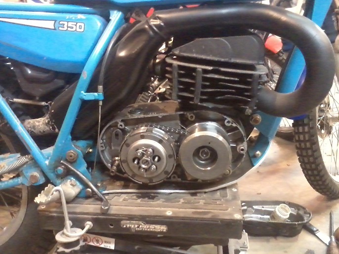

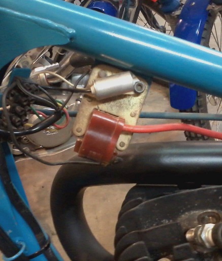

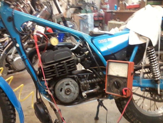

lbhbul Posted June 27, 2015 Report Share Posted June 27, 2015 Well maybe not much going on out there?? Made a little progress since last time, not a whole lot for most, but for me enough sitting on rolling seat to do me, and also stopped to help out a friend and do some machine work yesterday . Add a condenser Up on the lift for a little clutch work Now we can get it to where its easier to work on. Larry 5 Quote Link to comment Share on other sites More sharing options...

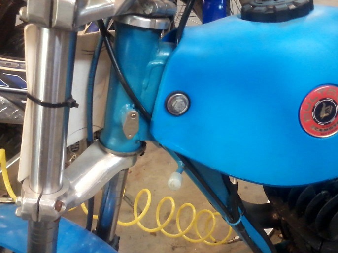

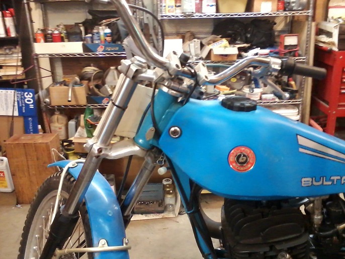

lbhbul Posted June 28, 2015 Report Share Posted June 28, 2015 Yesterday trying to get myself going after several hours Friday helping my good friend to sort out the kicker on a MAR & chain tensioner/brake cross shaft repair, back on the 199a project. Not much but safety wire clutch and refit case, 300cc Dexron , change tank bolt configuration. stock tank bolt maybe cleaner 4 Quote Link to comment Share on other sites More sharing options...

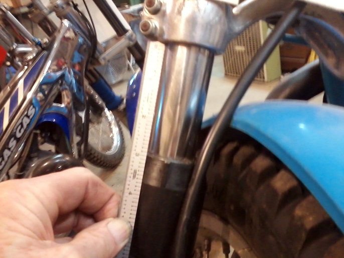

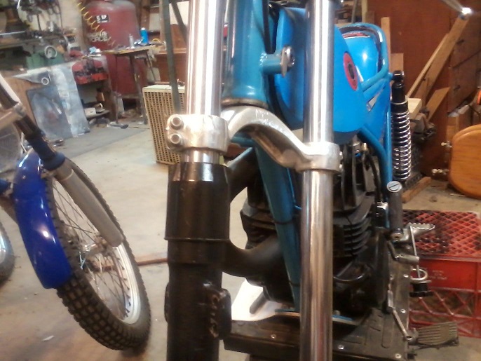

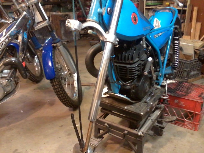

lbhbul Posted July 6, 2015 Report Share Posted July 6, 2015 Well guys the saga of the Blue Bultaco continues, on to fork seals, started out OK but then became complicated; sticky/stuck rather badly its the RH here we go got to fix this or junk it all better now I'll finish up the rest of the story later. Larry 1 Quote Link to comment Share on other sites More sharing options...
