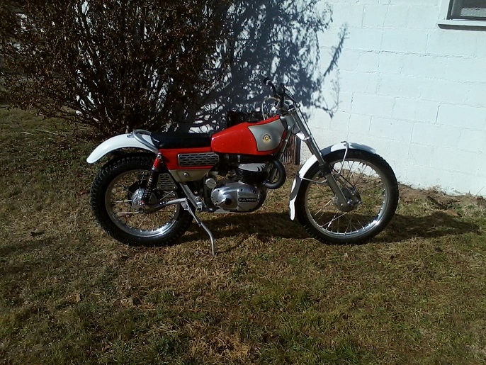

lbhbul Posted April 25, 2015 Report Share Posted April 25, 2015 Hencam, I believe you & I had a discussion some time ago regarding using a 138 Alpina rear wheel to get proper 199's rear brake. That said Feetups comment rang a bell, so went to the shop to check on a slip up my son & I pulled some years ago when building his M49, got a good deal on a set of Alpina wheels as the ones we had were the older Akront rims & we liked these. Needless to say the rear was fine, the front drum is 5.5 dia.140.omm Sherpa is 4.9 dia. 125.0mm so no go without the proper brake plate & shoes. I suppose we have had good luck with chrome, plenty of front brake but as I have already been informed, different climate. Larry 2 Quote Link to comment Share on other sites More sharing options...
scot taco Posted April 26, 2015 Report Share Posted April 26, 2015 Larry, that is a beautiful bike,very nice work! 1 Quote Link to comment Share on other sites More sharing options...

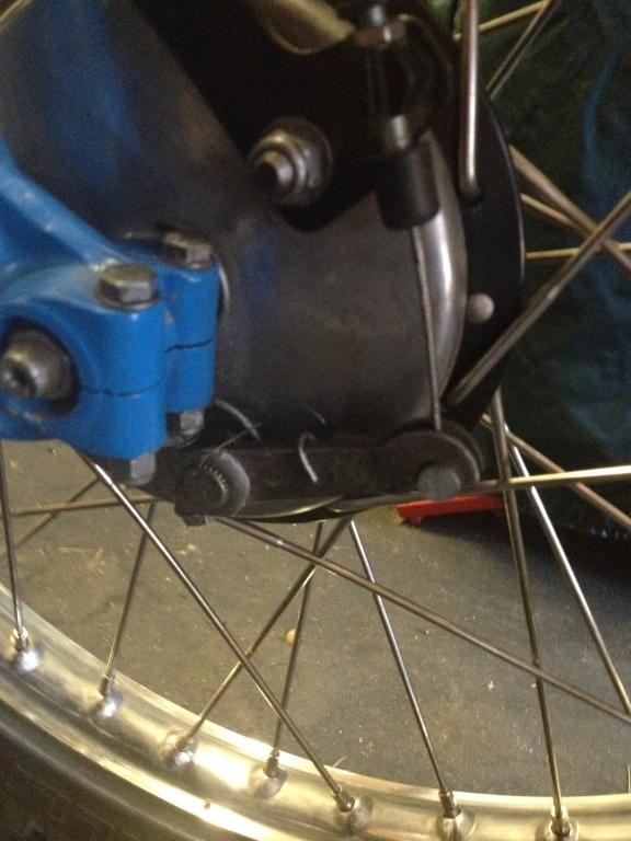

bultaco 199 Posted May 3, 2015 Report Share Posted May 3, 2015 Hi Chaps, My 199b front brake chrome drum was in perfect condition with new shoes fitted it worked well and would lock the front wheel if needed so all good. My only criticism was that adjusting it so it was just binding the handle bar lever had a lot of movement. Any way I had read a lot on here about buying a aluminium front bake operating arm to put on the clutch to increase the leverage and lighten the clutch operation (replacing the shorter steel one). So as it was Sunday and In Motion were shut I thought I would simply swap them over putting the short steel operating arm on the front brake. Anyway with some adjustment the clutch was much improved (I also left off the return spring from the top of the clutch lever on the crankcase) I can know use it with two fingers. But what surprised me is the front brake is now fantastic! Much shorter travel one or two finger operation and still enough leverage to lock up the front wheel if needed. And all for free. I just had to have a ride around the block (it is road legal) now my bike rides on two finger controls. Happy days. Martin. 3 Quote Link to comment Share on other sites More sharing options...
