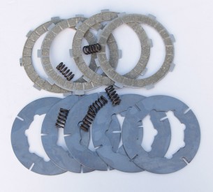

bondy Posted May 3, 2015 Author Report Share Posted May 3, 2015 scot what clutch plates are you using? i got these for my 199B 2 Quote Link to comment Share on other sites More sharing options...
bondy Posted May 4, 2015 Author Report Share Posted May 4, 2015 scot you can still buy the original steel clutch plates like these i have spare. new Quote Link to comment Share on other sites More sharing options...

millerme Posted May 4, 2015 Report Share Posted May 4, 2015 save money and buy the Barnett clutch from the states it cost me £35 inc p&p and I didn't pay any duty on mine 2 mths ago if you use a seller that send them as std just use 4 plates not the 5 they send and use you original springs as the Barnett one are to strong ,bath them for 24 hrs in ATF the fit a old steel plate then a fibre plate and so on ,And this will give you 2 finger clutch hope this helps 3 Quote Link to comment Share on other sites More sharing options...
smelling123 Posted May 4, 2015 Report Share Posted May 4, 2015 I also have them as described by millerme with the springs backed off a little and a venhill cable - one finger action works great 4 Quote Link to comment Share on other sites More sharing options...
bondy Posted May 4, 2015 Author Report Share Posted May 4, 2015 (edited) Yes i have the same set up as smelling 1 finger also i didn't use the barnet springs as millerme says there to stiff.ignition case mod and longer clutch Arm good cable with clutch springs backed off all go to make it nice and light. i do have the original plate new not sure if i will use them on next build or buy more barnet plates. Edited May 4, 2015 by bondy 2 Quote Link to comment Share on other sites More sharing options...
scot taco Posted May 4, 2015 Report Share Posted May 4, 2015 bondy,I talked with Larry the other day on a good clutch set-up and yes I will be using the Barnetts Thank you and everyone else for the heads up on how well they work. Scott Quote Link to comment Share on other sites More sharing options...
bondy Posted May 4, 2015 Author Report Share Posted May 4, 2015 Hello Scot yes they are good just use 4 not 5 and old springs if you have longer clutch Arm use it will make it lighter my clutch basket is made from alloy some are steel. 1 Quote Link to comment Share on other sites More sharing options...
