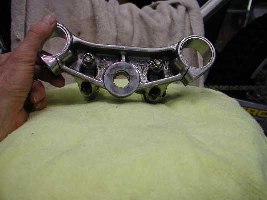

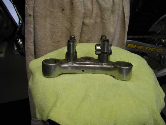

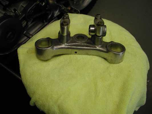

wayne thais Posted September 15, 2005 Report Share Posted September 15, 2005 I have installed the fat bars (Hebo and Tag) three different ways on my Sherco's. Here are the ways: 1. I used a "99" top clamp on an "04" with the Hebo/Tag adapters. 2. I used a Gas Gas top clamp on an "05" again with the Tag adapters. I do not know what gg the clamp came off of. I had to have a spacer made for the steering tube as the Sheco tube is a bit smaller than the gg. 3. On an "02" I machined out the stock Sherco top clamp and used the Hebo top clamp. I used long bolts and had to put them in at a slight angle to make everything fit up nice and tight. If there is a will there is a way. Wayne Quote Link to comment Share on other sites More sharing options...

neo Posted September 24, 2005 Report Share Posted September 24, 2005 Hey Wayne, Any chance of some more details or a photo of point 3 above? Best of balance. Neo Quote Link to comment Share on other sites More sharing options...
wayne thais Posted September 25, 2005 Report Share Posted September 25, 2005 I hope the pictures come through. Here are pictures of my modified triple clamp, the socket shown is the one that I used to determine the correct diameter to open up the stock clamp. Wayne Quote Link to comment Share on other sites More sharing options...
n.wales_sherco_lad1 Posted September 27, 2005 Author Report Share Posted September 27, 2005 nice yokes. Cant see them that good though. lol . Are you selling the yokes?????? Quote Link to comment Share on other sites More sharing options...
