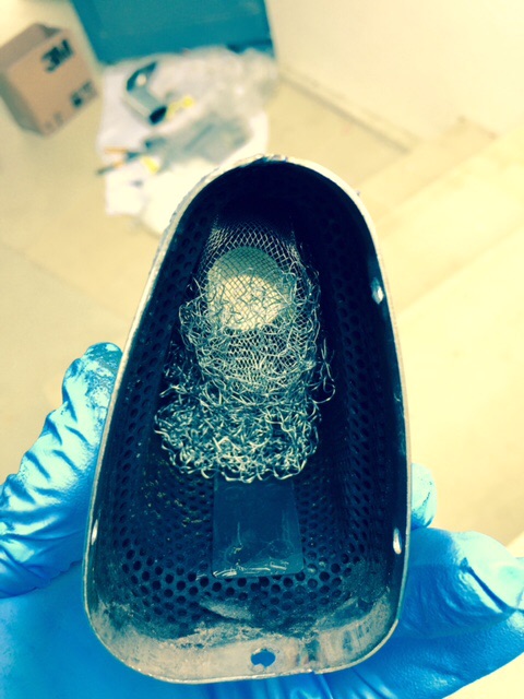

The inner plate of the end cap comes apart in much the same way as the KTM. I removed this. Over the final outlet (inside the end cap), which is kind of oval shaped, I put a tea strainer domed in the direction of flow and held it in place with more mesh. I hoped the mesh would also take out some of the noise by resonating. Tea strainer mesh was all I could find on the day but will probably change this for a different mesh with larger holes at some point. Assembled and riveted the end cap on. Fitted to bike. Warmed up the bike.

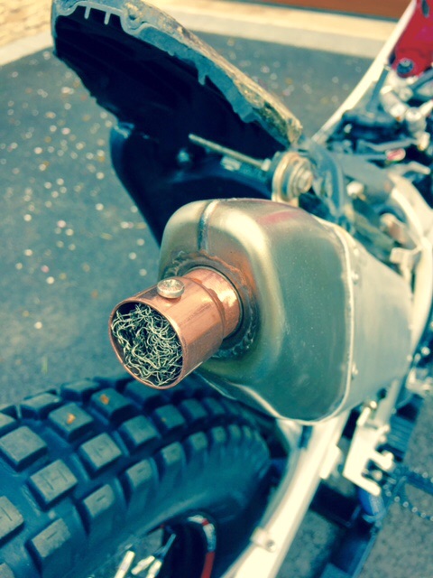

Back at the garage I prepared phase two! A 28mm X 22mm end feed reducer. The 22mm socket end was carefully ground down to create an interference fit (i.e it needed a mallet to 'tap' it in. I inserted another rolled piece of knitted exhaust SS mesh. See pic. Then drilled down through the mesh and out the other side of the fitting into which a long self tapping screw was inserted, ground off the excess. Started the bike and offered it on/off the end of exhaust outlet, revved it up to see if any difference. A VERY noticeable difference, especially to the 'after burble' when you close the throttle. Great. Tapped it into exhaust. (Note: the last picture below doesn't show the fitting tapped in all the way. It obviously goes in as far as the taper of the fitting). Went out for an hours ride this evening - it's a brilliant mod. The sound is now nice and smooth. The weird thing is I expected the power to be killed quite a bit, but it's absolutely fine. I would say you have to crack the throttle a little more than before to loft the front but I mean a little.

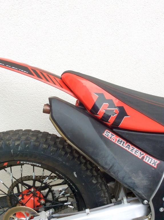

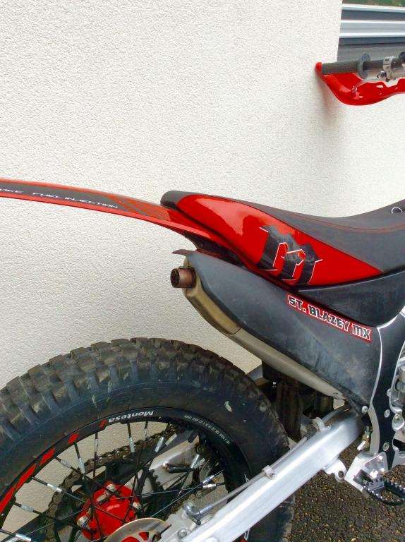

Pictures below showing the finished job as the image above makes the end cap look huge and in reality it looks fine.
