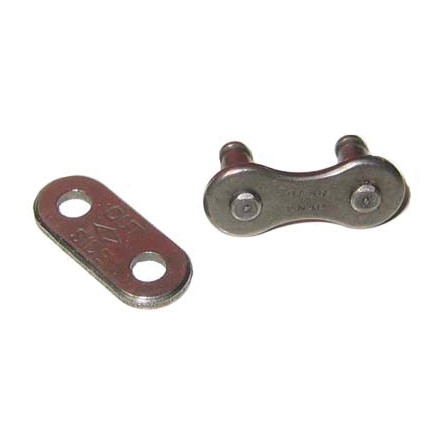

fulltilt Posted May 15, 2015 Report Share Posted May 15, 2015 I believe there are master links available that you can beat the end over with a hammer and then they're as good as any other link. And, what I'm sure you all know already; I always put the clip on the inside and the open end facing back, so it's less likely to pop off it hits a rock or stump. http://www.motosport.com/did-master-link-520erv3-xring 1 Quote Link to comment Share on other sites More sharing options...
