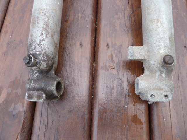

Finally i got OSSA Mar forks for my BSA C15 project.
I have couple of questions,
> There is oil leak from screw on fork leg. I tried to tighten it , but its thread is gone , how to fix it ?
> What is easiest way to hook OSSA forks to C15 ? . Should I use C15 ball bearing race to OSSA yokes.
or should i use C15 yokes ? and OSSA forks legs . I prefer to use OSSA yokes if possible , they seem more suitable to me.
I am attaching pictures .. please advise.
Thanks in advance
Cheers
Talha
Link to comment
Stripped thread - get it Helicoiled. You can buy kits on line, for not a lot and I bought a multi size kit over ten years ago and come in handy many times. I used an Ossa front end on a BSA and made two inserts to convert the BSA steering head to take metric tapper roller bearings. Simple and quick, worked well for many years.
