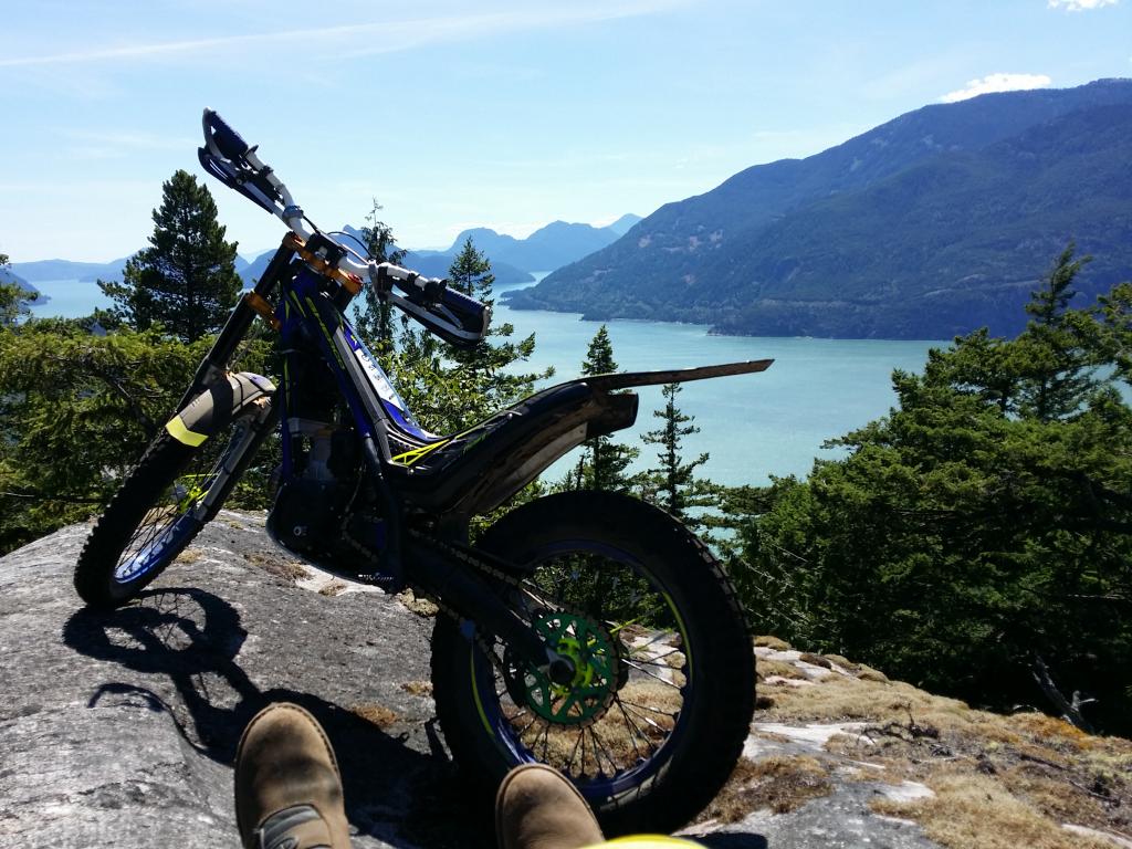

Well, I finally got all of my personal touches on my Factory edition ST300.  Here's a list of what I've done.. I'll report back after riding tomorrow.  I had a 15 ST300 before this, so I have a baseline to compare to.  So far, in the one test ride I can say it's much more confidence inspiring, and more natural feeling so far.
Changes from new include:
- bleed brakes with Maxima DOT4 racing fluid
- Zeta levers
- Acerbis handguards (I'm one of those guys)
- stiffened up the compression on the front forks and increase the bottom out resistance setting
- 2 turns more preload on the rear to speed up the steering
- 2 clicks in on the rear Ohlins to help with the big hits
- D.I.D. VT2 x-ring chain - Riveted on
- 43T rear sprocket
- S3 10mm back steel pegs
- Full plastic-carbon look protective crap (This stuff is really NOT adding to the look of the bike at all), I'd do the frame guards, and full length fork guards only next time
- slightly thicker and colour co-ordinated ODI grips, which actually feel really nice, they aren't thick, just thicker.
- CSP high volume water pump
- Completely cleaned up each clutch plate, and this really makes the clutch feel great.. I'm happy I did that!
No pics just yet.. Must wait for sunshine and a great backdrop!
Thanks to International Motorsports, in Langley, BC for helping me out with getting my hands on this beauty!
Jon

Well, I'm out riding right now and enjoying the awesome trails of British Columbia. So far the bike is much more lively, and it is taking some getting used to the extra response. I don't ride competitively, just play ride in the backcountry.
