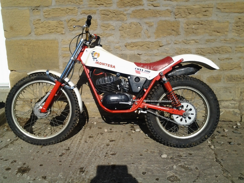

talbotvanman Posted June 25, 2015 Author Report Share Posted June 25, 2015 (edited) Well it wasnt easy but there it is !!! Very original I would say although I do want to replace the levers. The red seat is something I havent seen before but is definately Montesa having the " M " embossment in the side. Edited June 25, 2015 by talbotvanman 1 Quote Link to comment Share on other sites More sharing options...
29markt Posted June 26, 2015 Report Share Posted June 26, 2015 How is the chain tensioner mounted? I have just acquired the original chain tubes to fit to mine, but prefer the look of the tensioner as you have fitted, nice original looking bike that is! Cheers. Quote Link to comment Share on other sites More sharing options...

4stroke Posted June 26, 2015 Report Share Posted June 26, 2015 They all had chain tubes from new. You may need to fit a chain guard to keep mud off your chain. Replacement tubes and brackets are available. Have fun! 1 Quote Link to comment Share on other sites More sharing options...
29markt Posted June 27, 2015 Report Share Posted June 27, 2015 (edited) Chain tube bracket and tubes available as 4stroke say's, got mine of a chap on my group, and the bracket from inmotion, but they stock tubes also, I have some engine parts contacts in Spain, gears/shafts/selectors etc if you ever need. Cheers, Mark Edited June 27, 2015 by 29markt Quote Link to comment Share on other sites More sharing options...
lbhbul Posted June 27, 2015 Report Share Posted June 27, 2015 SM offers a universal tensioner similar to the one shown, would require a tab to be welded to swing arm cross member. Larry Quote Link to comment Share on other sites More sharing options...

talbotvanman Posted July 12, 2015 Author Report Share Posted July 12, 2015 (edited) zerorev3rev4 yes it came from your neck of the woods was it trialed much ? if so good riding cause it aint knocked about at all to the point I wondered if it had been a "farm" byke only !! curious about the red seat never seen one before. Edited July 12, 2015 by talbotvanman Quote Link to comment Share on other sites More sharing options...
zerorev3rev4 Posted July 26, 2015 Report Share Posted July 26, 2015 hi it was bought as a non runner and was the early cota 200 a later frame came up ( with the engine guards and narrower top shock mounts ) already painted ready to go so i transferred the engine and other parts adding other parts which i had to build what you have today , the seat prob came from another bike i think its just the standard seat with a red leather cover been made ,, it was originaly for sale from Middlesbrough poss on gumtree or piston heads , then paul hanley from crook bought it he didnt get to do anything with it and i ended up with it ,rebuilt it and past it on to a neighbour which sold it to you so non of us actually used it , it did have a white frame with an extended swing arm all in all it made a fairly decent little bike Quote Link to comment Share on other sites More sharing options...
talbotvanman Posted July 27, 2015 Author Report Share Posted July 27, 2015 Thanks for that interesting info of the bikes history As you say a decent bike that performs well certainly for what I will be doing with it ! Mainly keeping an eye on my seven year old grandson on his Oset while my son competes. Now Mark asked about the chain tensioner. I have " bin on me hols " so not had a chance to photo it but looks to be original as I cant see any obvious bracket welding. Perhaps you could comment on that ? Cheers and thanks again. PS Fell off and snapped the none original brake lever so fitted a matching Amal. LOL Quote Link to comment Share on other sites More sharing options...
zerorev3rev4 Posted July 28, 2015 Report Share Posted July 28, 2015 chain tensioner is prob from inmotion just a hole drilled through engine cradle and mounted from there ,, originals were mounted to lower engine casing but when chain comes off it breaks the casing Quote Link to comment Share on other sites More sharing options...
