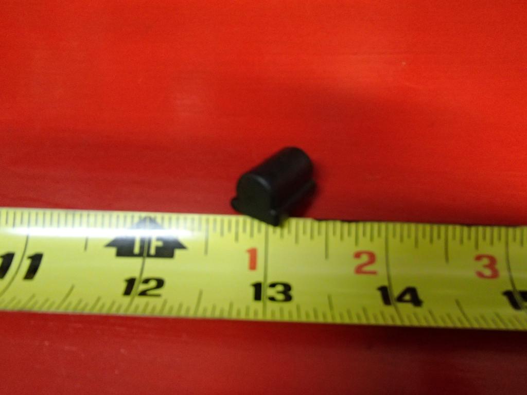

Never had to replace it but have had the cover off several times. It is fiddly for sure, I think I found it easier with the bike leaning over but you just have to watch the clutch top hat to make sure they don't slip below the fingers. The stopper itself just slides into its place. I think I have a "how to" on clutch cover removal and will email to you later when I get to work

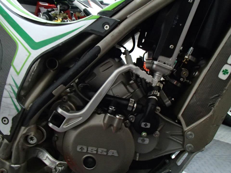

 Be sure to have a good look at your own levers position.There is a chance of doing some damage if bits of that rubber stopper get into places it shouldn't be.And without it,the inside of the cranckcase will be damaged.Here is a before and after pic.(yes,it's the same bike)
