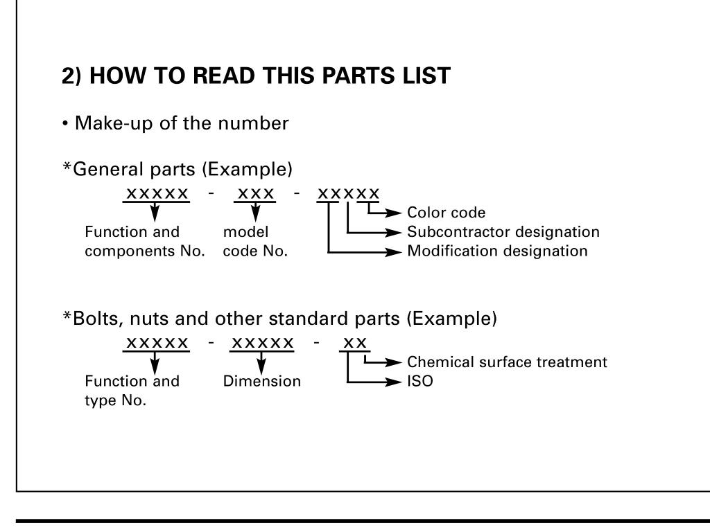

jj65 Posted June 29, 2015 Report Share Posted June 29, 2015 Part number for a 2005 bike: 50600-NN4-000 50700-NN4-000 Part number for a 2014 bike: 50600-NN4-D00 50700-NN4-D00 The D in the last three digits donates a modification, I don't know what's different, could be colour or shape. Why don't they fit? If it's because the foot rest are tilting up (not flat) that's normal for S3. 1 Quote Link to comment Share on other sites More sharing options...
