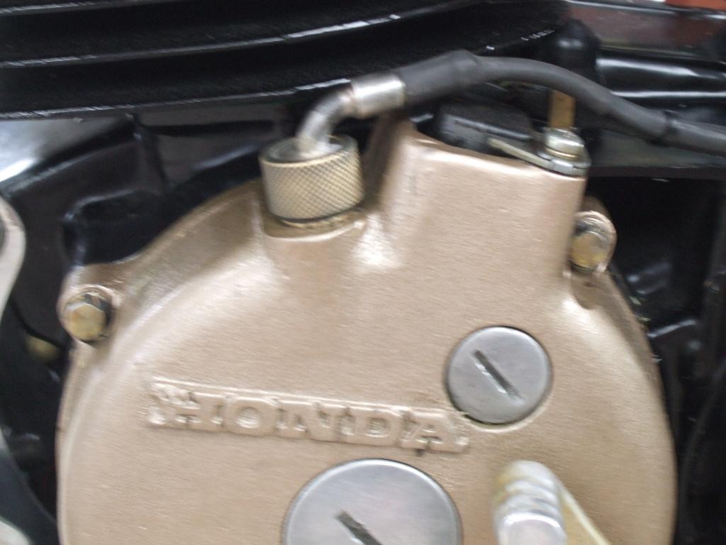

shedracer Posted July 1, 2015 Report Share Posted July 1, 2015 Hi, i am getting very near to the completion of my RTL rebuild, however I am struggling to get a part to replace a damaged one. The AC Generator cable, that come out of the engine generator cover (seen in the attached photos), it has a small rubber elbow grommet, which is in very poor shape. Does anybody know if this rubber grommet can be replaced, or have any suggestions for an alternative, or to repair it? I would very greatfull for any suggestions. Many thanks. Quote Link to comment Share on other sites More sharing options...

shedracer Posted July 1, 2015 Author Report Share Posted July 1, 2015 I have been in touch with David Silver parts, it is a complete assembly, ie you've had to buy the whole generator assembly, and they are no longer available, sadly. I'm currently looking at a product called VersiMold, which is a mouldable silicon rubber, which cures when heated. The only thing I'm not to sure is if it can handle the engine temperatures, but I have sent a question to the company that makes it. If it proves to be to handle the heat and oil contact, then it will be ideal to mold into the engine case and around the wires, finger crossed. Quote Link to comment Share on other sites More sharing options...

andywalker Posted July 2, 2015 Report Share Posted July 2, 2015 Mine leaked oil out of the grommet, i tried silicone sealant on the outside but the oil still found a way through, i eventually sorted it by taking the casing off and fully degreasing it inside and out then applying the sealant on the inside around the grommet, did that over a year ago, the bike gets used regularly, so far its been spot on. 1 Quote Link to comment Share on other sites More sharing options...
joelewis Posted July 21, 2015 Report Share Posted July 21, 2015 As above, I took the casing of, degreased it then put Ducati sealant (I had that kicking around) on the inside. I did that around 6 months ago, I've done 6 ish trials on it and no problems since. Quote Link to comment Share on other sites More sharing options...
