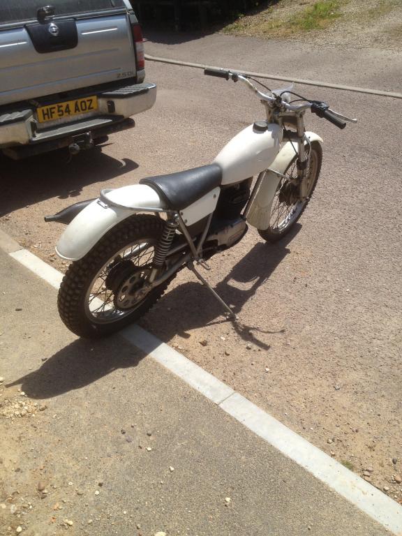

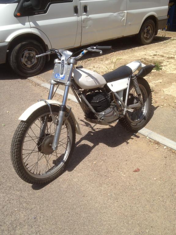

tricksport Posted July 7, 2015 Report Share Posted July 7, 2015 I recently got my first classic bike, from a friend who just wanted it out the garage. He has said its a ossa mar 250 mick andrews rep. I don't know enough about it, to know for sure if it is what it is claimed to be. Any help and advice much appreciated. Earl 1 Quote Link to comment Share on other sites More sharing options...
cleanorbust Posted July 7, 2015 Report Share Posted July 7, 2015 Yes, looks to be a Mark 1 Mick Andrews Replica, circa 1972, 244cc. The mudguards are non-standard (originally alloy), as is the silencer. Looks to have Sammy Miller front mudguard stays, which were an improvement on the originals, and of course it's been painted all white, original colour scheme was green/white. It's also had a metal sump guard fitted, the original models had one made of a material touted as carbon fibre which wasn't really up to the job. Looks like it's also had a replacement flat rear sprocket fitted with a spacer at some time, the original being a dished design. The bike was one of the earliest on the UK market to have pointless transistorised ignition, which was known to give up the ghost after a certain time. Hopefully yours is OK. Parts should be available from In Motion trials. One disadvantage is that the fuel tank looks like the original, ie fibreglass, which doesn't cope well with modern petrol. All in all though it looks like a reasonable example which, if you got it for little money, could be a good find. Quote Link to comment Share on other sites More sharing options...
woody Posted July 7, 2015 Report Share Posted July 7, 2015 Yes, it's an Ossa MAR MK1. Model year from 72 to early 74. Looks in pretty well original condition, just missing the green stripe on the tank and side panels. If the carb is mounted by rubber hose it will be a later model MK1 unless someone has fitted another cylinder, First MK1 came with a bolt on carb. Rear silencer is from another bike, probably a Montesa Cota 247 as it's been cut up a bit. Early MK1 has a peashooter style silencer (which didn't...), kater MK1 has a bullet shape. Sidestand isn't original as they bolted to the other side (not that it matters) although some MK1 didn't have the bracket on the swingarm and came without one. Quote Link to comment Share on other sites More sharing options...

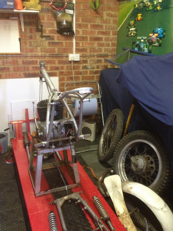

tricksport Posted July 9, 2015 Author Report Share Posted July 9, 2015 So it begins! 1 Quote Link to comment Share on other sites More sharing options...
