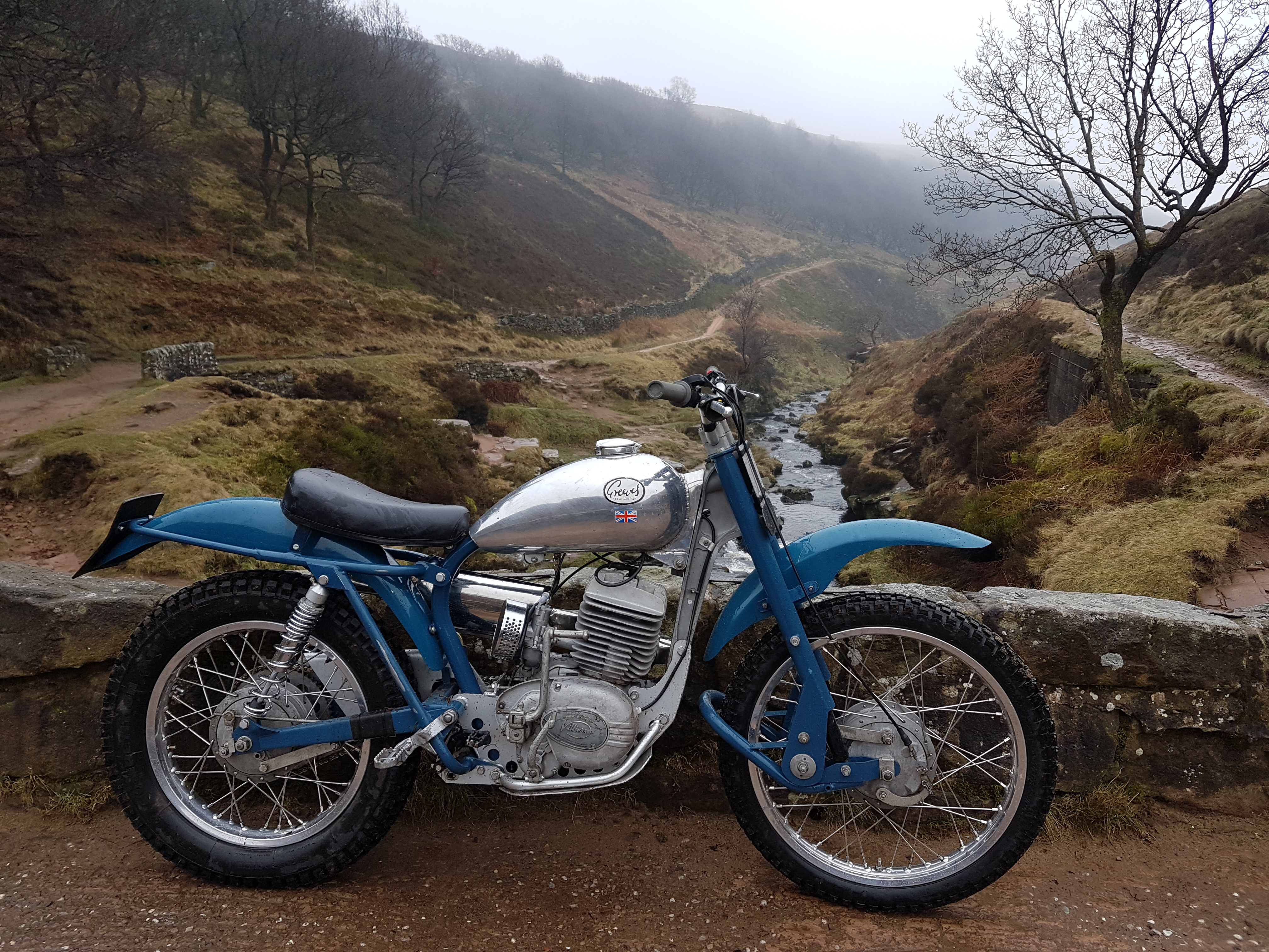

Just thought I'd update this post I've finally sorted the running problems. First fault (starting/reving)was the brand new carb which has been swapped for a new amal premier carb, the second fault was a combination of things (gettin hot/pinking), turns out these Villiers engines have a usefull feature of a drain plug in the crank cases, which had come loose on mine and was letting in a small amount of air making it run hot, so that got a new copper washer and some thread tape making it run a lot better but not perfect, whilst talking with a couple of riders whilst out practicing they mentioned about the squish with it having a rebuild, so that was checked and found to be very tight/narrow so I've used a copper head gasket I had off another bike and what a transformation the bike is a complete different animal, so thanks to those who posted ideas and maybe this might help others in the future because there's nothing worse than a thread with no update on whether a fault has been fixed, here's a pic of it now it's finished 20170310_111823.jpg
