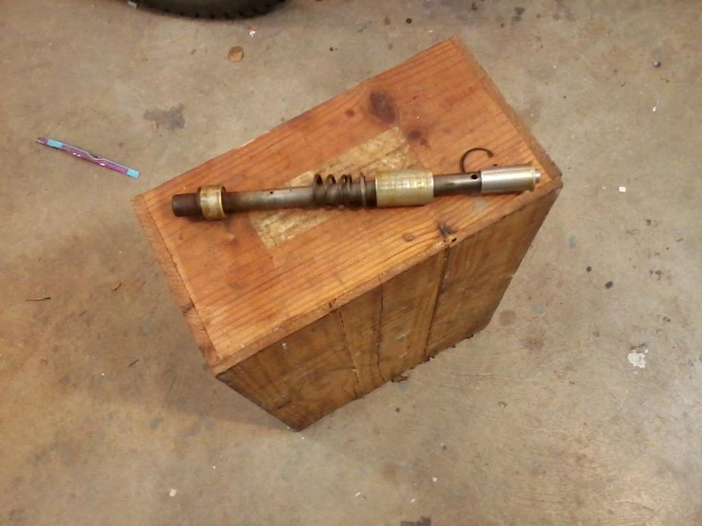

lbhbul Posted July 17, 2015 Report Share Posted July 17, 2015 Cosmo, Unless there has been a long 6m screw turned in against the damper they should only be stuck to the bottom of the slider with accumulated gunk or corrosion. Damper assembly the damper is secured in leg by a circlip, the slider comes off after the bottom 8m allen head is removed. Be sure to replace the O-Ring seal. Larry 1 Quote Link to comment Share on other sites More sharing options...

lbhbul Posted July 17, 2015 Report Share Posted July 17, 2015 Cosmo, a help would be a longer M8 bolt screwed well into the damper, then tapped with a small hammer along with some penetrating oil, should come along nicely, springs out of course. Let us know how you get on. Larry 2 Quote Link to comment Share on other sites More sharing options...

lbhbul Posted July 21, 2015 Report Share Posted July 21, 2015 (edited) Stuart, my best luck with seals; removal can be facilitated with a bit of heat and careful levering and soft alloy to lever against so as not to harm the slider,( I don't own a proper seal puller ). 1 seal per leg 35x47x10, I like to cut the female end of the seal spring by about 1/4 inch to ensure better sealing, (not my idea but it sure works). Good Luck Larry Edited July 21, 2015 by lbhbul 1 Quote Link to comment Share on other sites More sharing options...
