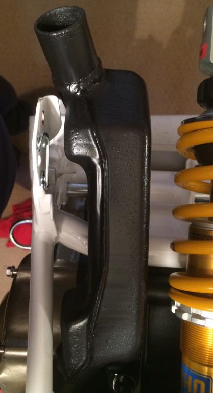

joelewis Posted October 30, 2015 Author Report Share Posted October 30, 2015 (edited) Hello 4stroke, We were talking about your question this morning - it would be possible. At the moment though we will be concentrating on just getting the complete silencers made up. I sent my exhaust away again for moulds to be made of the back section ( I didn't want to do this before until I could see how the front skin came out due to costs of getting moulds made) I know it was mentioned earlier about thickening the back section to get over the fact of the rear wheel rubbing on the tyre. I aren't doing this. it will be as original. You can get over this anyway by slightly forcing the silencer out on the original bracket, you do have a slight bit of movement. I've also borrowed a bore scope to look inside to see what the baffles look like. I've been on the look out for a knackered knocked about exhaust to cut up but nothing has come up. I certainly aren't cutting mine up. A second prototype front section was done yesterday evening. Huge difference. still work need but hopefully you can tell the difference in this picture and the one above. First. Second. Thanks, Joe Edited October 30, 2015 by joelewis 1 Link to comment Share on other sites More sharing options...

joelewis Posted October 30, 2015 Author Report Share Posted October 30, 2015 Price will be around the £450, it isn't been done to a price though, the price will be however much it is to get it right. Although in my opinion its good when you compare it to the stock silencers you get for the TLR's at £200 - 250. Especially when you look at the quality of them compared to even at this stage the detail in one of these. Next update will be 2 - 3 weeks, we should then have the back section with us then its just a case of fixing together / baffles / bracket / collar etc. Was pretty exciting seeing this second template. As upto now it seemed like nothing was progressing. Joe 2 Link to comment Share on other sites More sharing options...

joelewis Posted December 30, 2015 Author Report Share Posted December 30, 2015 Hello Doug, The skins would are ready now - but currently concentrating on the complete exhausts before anything else. The mid box section between the silencer and front pipe would be pretty simple to make - that wouldn't be an issue. Mine is fine so I have no need to look into it but it could be done? Slight update. Another apology due to time taken but due to other work commitments its been on the back burner. We got the back section mould back a couple of weeks ago, will get the back section pressed in the next week or so but the mould has come out perfect. Hope everyone has had a good Christmas & and have a good New Year. Will update when more progress is made. Link to comment Share on other sites More sharing options...

joelewis Posted January 28, 2016 Author Report Share Posted January 28, 2016 Back has gone really well - done abit of refining on the moulds and the back has come out perfect pretty much straight from the mould. Looking to get first one built up by end of next week - end is in site! I don't think I'll be a Telford, I want to but I think I'll be needed at work. 1 Link to comment Share on other sites More sharing options...
