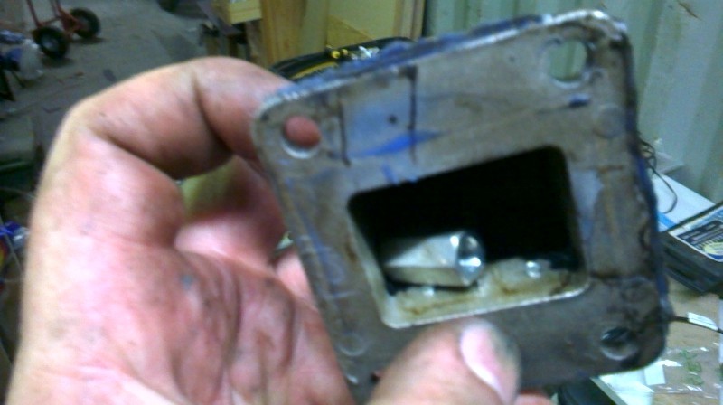

nickyburnell Posted August 20, 2015 Author Report Share Posted August 20, 2015 Thanks. Well! Throttle done, 10t to do, went to change the reeds tonight, check the picture. To say lucky is an understatment. Wonder how long thats been rattling about in there. Considering there is a small aperture bit that goes on in front of that bit, someone has been very careless Quote Link to comment Share on other sites More sharing options...
copemech Posted August 21, 2015 Report Share Posted August 21, 2015 That is a GasGas inlet restrictor! Just add another if it is still too quick! 1 Quote Link to comment Share on other sites More sharing options...
