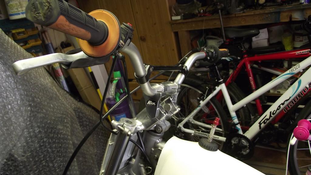

andy.t Posted August 17, 2015 Report Share Posted August 17, 2015 Sorry if its been mentioned before. I have modified some yokes in the past to move the handle bars forward but I have just fitted some nice TY250 forks and Yokes to my 175. I didn't want to cut up the yokes like I did before so I thought I would try some Rox Risers. I like the extra height and adjustment that they give you. Just thought I would give it a mention for those people seeking some extra bar height 2 Quote Link to comment Share on other sites More sharing options...
lineaway Posted August 17, 2015 Report Share Posted August 17, 2015 You have just lost leverage, and the ability to get far forward (Or back) on the bike. Quote Link to comment Share on other sites More sharing options...
andy.t Posted August 17, 2015 Author Report Share Posted August 17, 2015 lineaway, I haven't noticed that it changes the way the bike handles. Not sure why it would but I'm sure some scientist out there is about to tell me how it does. PS if that's a photo of you climbing a bloody great rock then I have to say I don't try that kind of thing on my TY so perhaps they might not be for you. Quote Link to comment Share on other sites More sharing options...
faussy Posted August 17, 2015 Report Share Posted August 17, 2015 (edited) You have just lost leverage, and the ability to get far forward (Or back) on the bike. You mean he has just gained leverage... The original handlebar mounting point looks inline if not slightly forward of the headstock, so moving the bars further away from this will gain him leverage. Rather neat risers by the way Edited August 17, 2015 by faussy Quote Link to comment Share on other sites More sharing options...

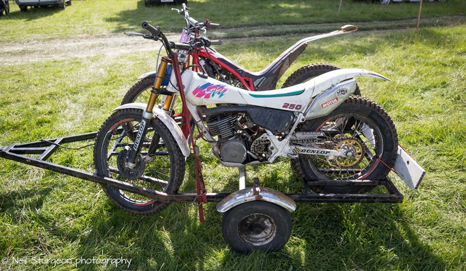

faussy Posted August 18, 2015 Report Share Posted August 18, 2015 (edited) I never said about putting risers on a modern bike, we are talking about putting risers on a ty to make it feel and ride more like a modern bike. Look at the angle of the yoke clamp. I agree these risers seem excessive, but i totally understand the idea. As said in the previous post id maybe try the riser tilted at 45 degree forward and a very flat set of bars, that would give some height and forward movement, something these bikes lack when in comparison against a modern bike. Look at the pic attached. This bike bike belongs to one of the best riders of a ty around back in the day. Look at the height and angle of the bars in comparison to the bars in your photo. Risers on a modern bike, not really, risers on a old bike like a ty to make it feel like a modern bike, yes. Styles change, id take a good guess if you transported your 2015 self having ridden modern bikes back to 1986 the first thing you would do would be to move your bars forward. Edited August 18, 2015 by faussy Quote Link to comment Share on other sites More sharing options...

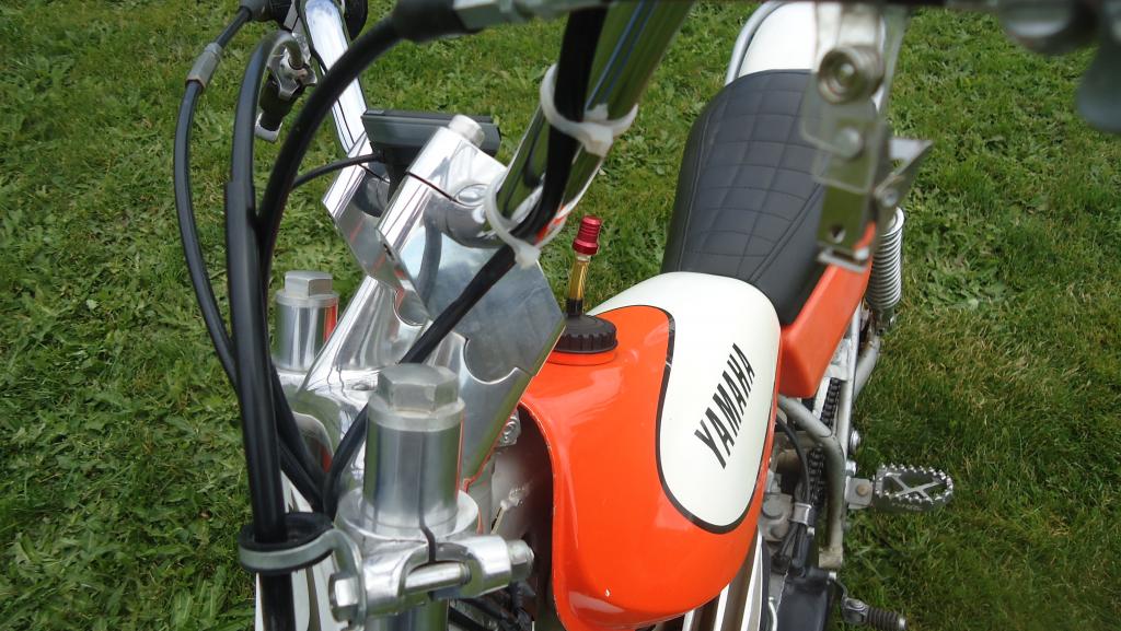

btc273 Posted August 19, 2015 Report Share Posted August 19, 2015 These are the risers I have used for several years, They allowed me to go to lower bars( the bars in picture are not the ones i have been using) and move them forward some and have made the bike handle better than stock . Quote Link to comment Share on other sites More sharing options...
