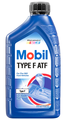

thesaint Posted August 18, 2015 Report Share Posted August 18, 2015 I have heard that ATF and ATF type F oil is the best oils to use on the gearbox for Gas Gas bikes. I also heard that on older bikes 5W-30 engine oil is used What kind of oil is best to use on my 1998 Gas Gas TX 320 both for the gear box and also for the fuel mix? Quote Link to comment Share on other sites More sharing options...
