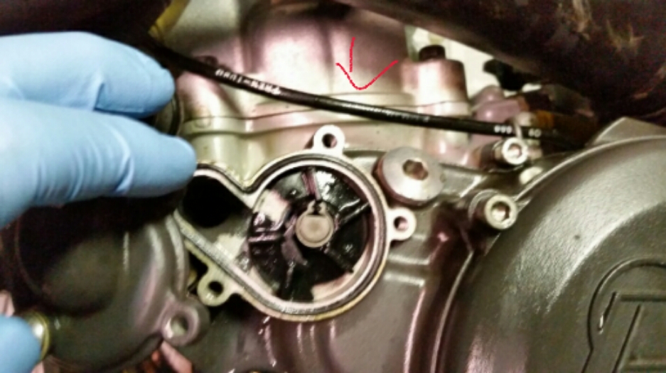

worldtrialchamp Posted August 26, 2015 Report Share Posted August 26, 2015 and what is that pipe/hose/cable next to the cylinder? something someone had added? Quote Link to comment Share on other sites More sharing options...
wayneniner Posted August 27, 2015 Author Report Share Posted August 27, 2015 and what is that pipe/hose/cable next to the cylinder? something someone had added?2015-08-27 08.00.54.jpg looks to be the hydro clutch cable... looks routed safely. Is that not the stock routing? (07 rev3 270) Quote Link to comment Share on other sites More sharing options...
wayneniner Posted August 27, 2015 Author Report Share Posted August 27, 2015 what's that black gunk in the water pump area(see pic)? (do you think one of the previous owners painted/coated to prevent corrosion?....is that the stock coating getting worn away?.. other?) Quote Link to comment Share on other sites More sharing options...
steve_earle Posted August 27, 2015 Report Share Posted August 27, 2015 The black stuff in the casing is the original coating (powder?). It was probably coated after casting then the faces machined. Coolant will soften it and it will peel away, Just have a scrape to rid it of any loose bits, Seen this in many water pump casings, nowt to worry about. Quote Link to comment Share on other sites More sharing options...
