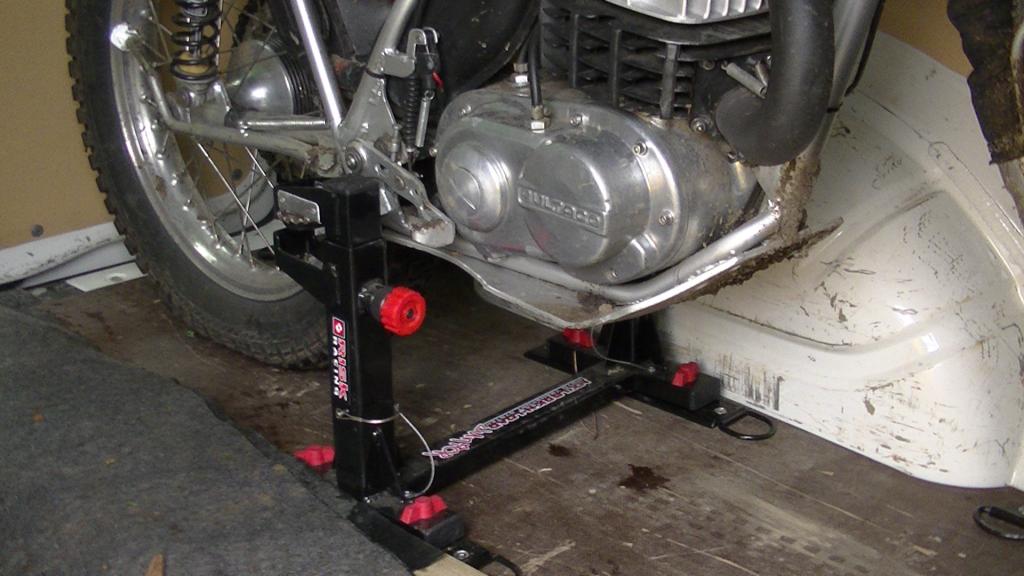

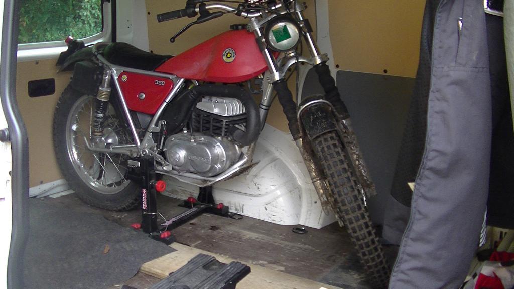

guys Posted September 11, 2016 Report Share Posted September 11, 2016 (edited) My apologies for being so late with my reply. I finally got round to installing the Junior Lock-N-Load system from Risk Racing. I used 8 nuts (see picture) to secure the system to the wooden floor of my van. And I must say I'm impressed: very easy to use and the bike is firmly locked in place. Note that I did add aluminium plates around the upper locking shackle to protect the pegs a bit. Edited September 11, 2016 by guys Quote Link to comment Share on other sites More sharing options...
