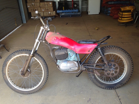

monty172 Posted September 18, 2015 Report Share Posted September 18, 2015 Hi all, I'm from Australia, in the NT where theres no trials clubs . Bought a 172 a few years back, used it a bit before some problems occurred - stalled when hot and wouldn't idle. I moved state and it was stored. Excited to pull it back out and get it usable again.. but am finding out fast how tricky it is to find parts. I'm handy with a spanner but a far cry from the expert. Where I'm up to is figuring what to do with the carb and fork seals. The Amal is pretty straight forward as I just need to decide between a new carby or a resleeve. Resleeve in Australia seems to be hit and miss. Where I'm really stuck is the fork seals. The originals are 31.5 x 45 x 7.1. Which is an impossible size to find, southwest stated same. Will 32 x 45 x 7 seals work? Doubting it.. More concerned about getting it rideable than keeping it original, so as I go will find whatever fits. I'll have a go at uploading her.. Quote Link to comment Share on other sites More sharing options...
29markt Posted September 18, 2015 Report Share Posted September 18, 2015 Hi, Sammy Miller in the UK show the seals as you mention as 32-45-7, so would imagine they would suffice.....http://www.smproducts.co.uk/products/suspension/fork-nuts?page=shop.product_details&flypage=flypage.pbv.v9.tpl&product_id=1005&category_id=85 Good luck with the restoration! Mark Quote Link to comment Share on other sites More sharing options...
monty172 Posted September 19, 2015 Author Report Share Posted September 19, 2015 Thanks Mark, Yep saw them, seems to be the only one who sells them too. As they're the closest matching thing around, I'll have to give them a go. Ben Quote Link to comment Share on other sites More sharing options...
