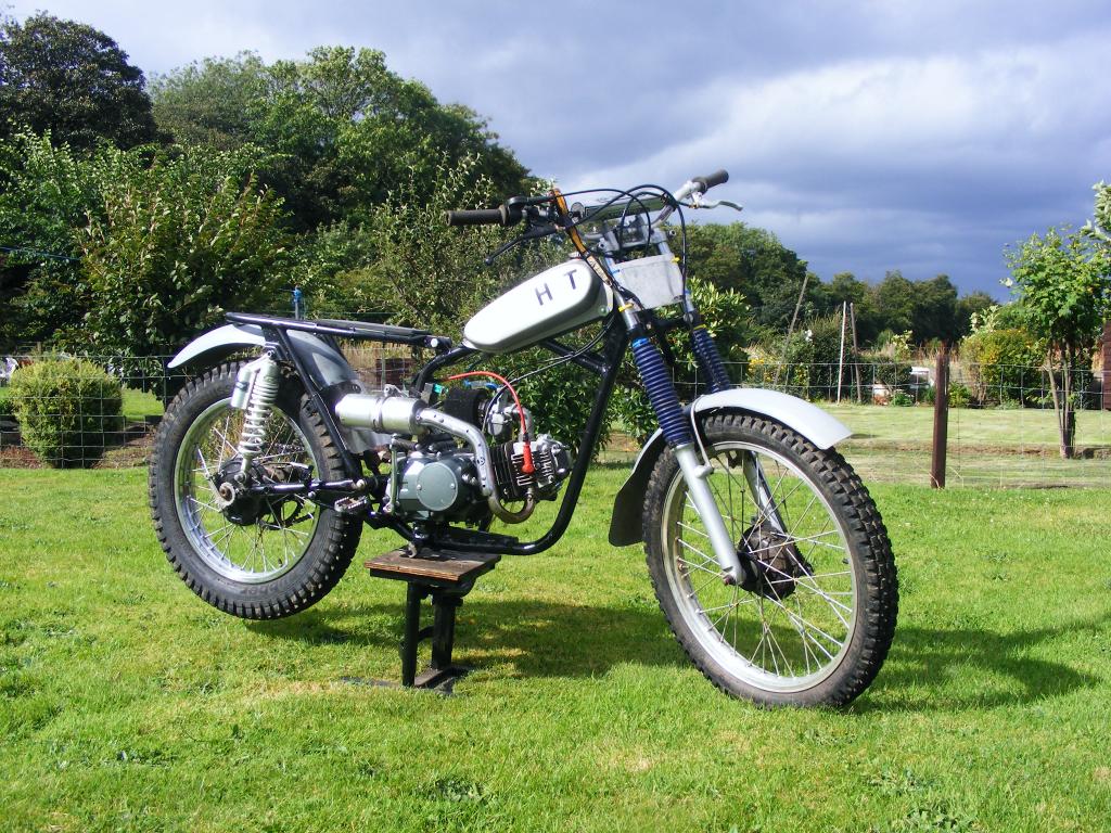

broony Posted November 7, 2015 Author Report Share Posted November 7, 2015 A wee update on the Peng Jian,grooved the front brake shoes and turned the front wheel round so the cable has a better run and fitted a domino lever,it know stops.Changed the fork oil-helped (will make spacers for the springs).Had a trial today with the Lothian trials club,best trial I've had so far on the bike.The wee bike was great and had plenty of grip in the tricky conditions.One complaint I have is that it doesn't use any fuel,seriously its brilliant on fuel. cheers the noo Brian 1 Quote Link to comment Share on other sites More sharing options...

broony Posted December 26, 2015 Author Report Share Posted December 26, 2015 Out on the bike today at the Lanarkshire Charity trial at Crieff Hydro,not been out on the bike since adding spacers to the forks and putting 20ml of extra oil in.Suspension is alot betterAlso first time with the new carb(Moklt 24mm) the bike ran well and pulled strong.Great day out despite the rain. The wee bike seems to be tough enough and takes a bit abuse well. cheers the noo Brian 2 Quote Link to comment Share on other sites More sharing options...

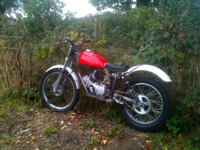

broony Posted September 11, 2016 Author Report Share Posted September 11, 2016 A wee change to Project 8x4,I stretched an old bantam frame and used the running gear from the original project.It's a work in Progress cheers the noo Brian 4 Quote Link to comment Share on other sites More sharing options...
charlie prescott Posted September 15, 2016 Report Share Posted September 15, 2016 (edited) Hi Brian, Bit of a trend setter there. I bet "Drayton" will Jump aboard, now they see that this is possible. They have fitted most other engines into a "Drayton Bantam" frame. And to be honest most of the engine parts in a Bantam are "Made In China" . I will update your Page OK. Regards Charlie.~Oo> Edited September 15, 2016 by charlie prescott Quote Link to comment Share on other sites More sharing options...
broony Posted September 15, 2016 Author Report Share Posted September 15, 2016 Thanks Charlie, I have not trialled the bike yet,still got a couple of things to do to finish it of.I lengthened the frame just over 3 inches.I put it on the old bathroom scales and its just over 80 kilos that's nearly 9 less than the original project. The old frame is now a fine garden ornament . cheers the noo Brian Quote Link to comment Share on other sites More sharing options...
