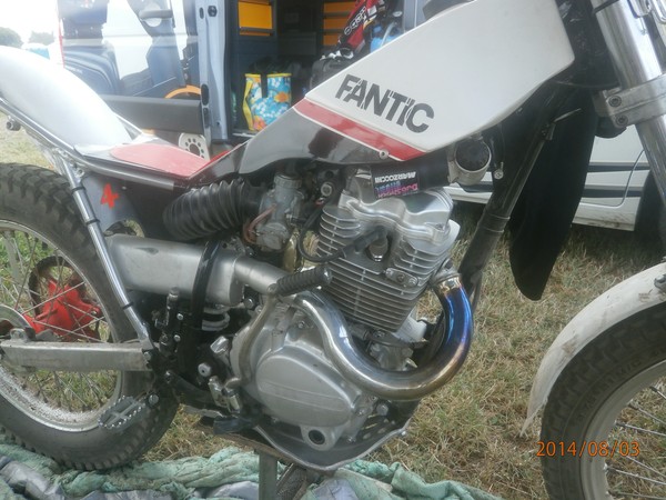

carl ekblom Posted September 29, 2015 Report Share Posted September 29, 2015 This is not my bike but it´s nice Quote Link to comment Share on other sites More sharing options...
