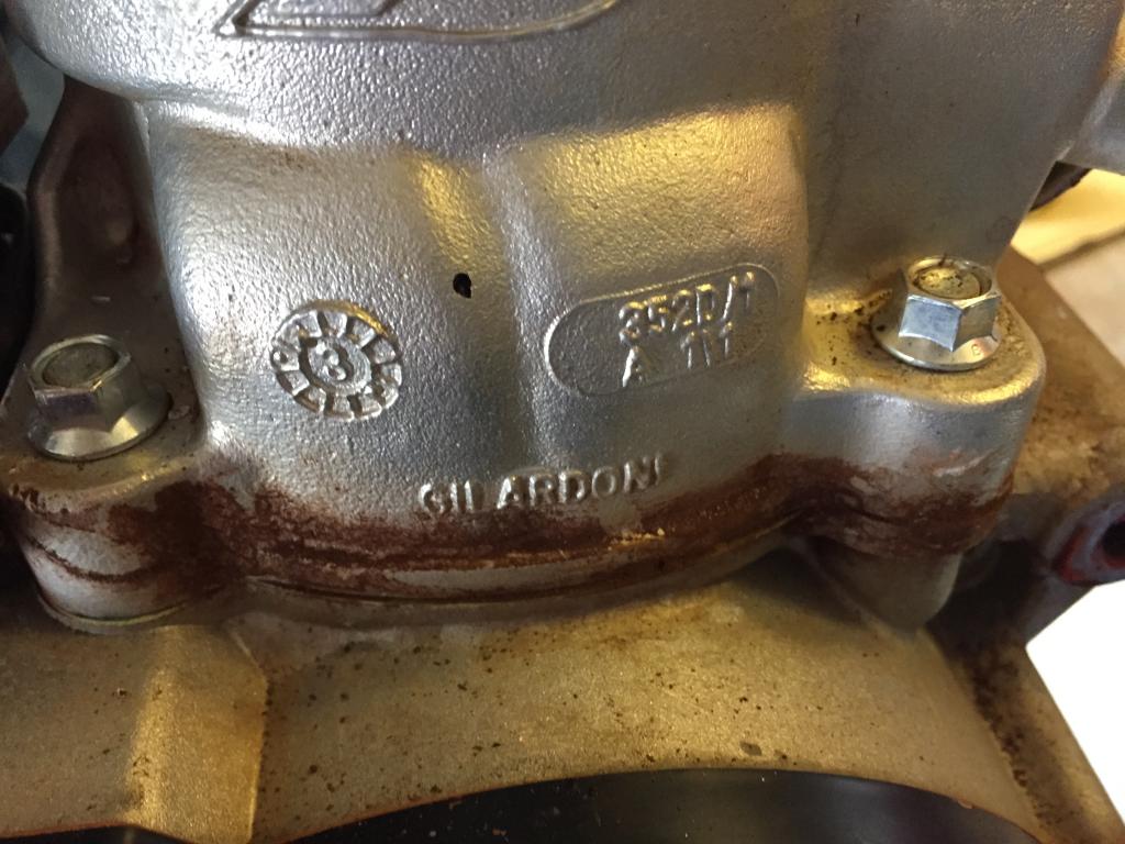

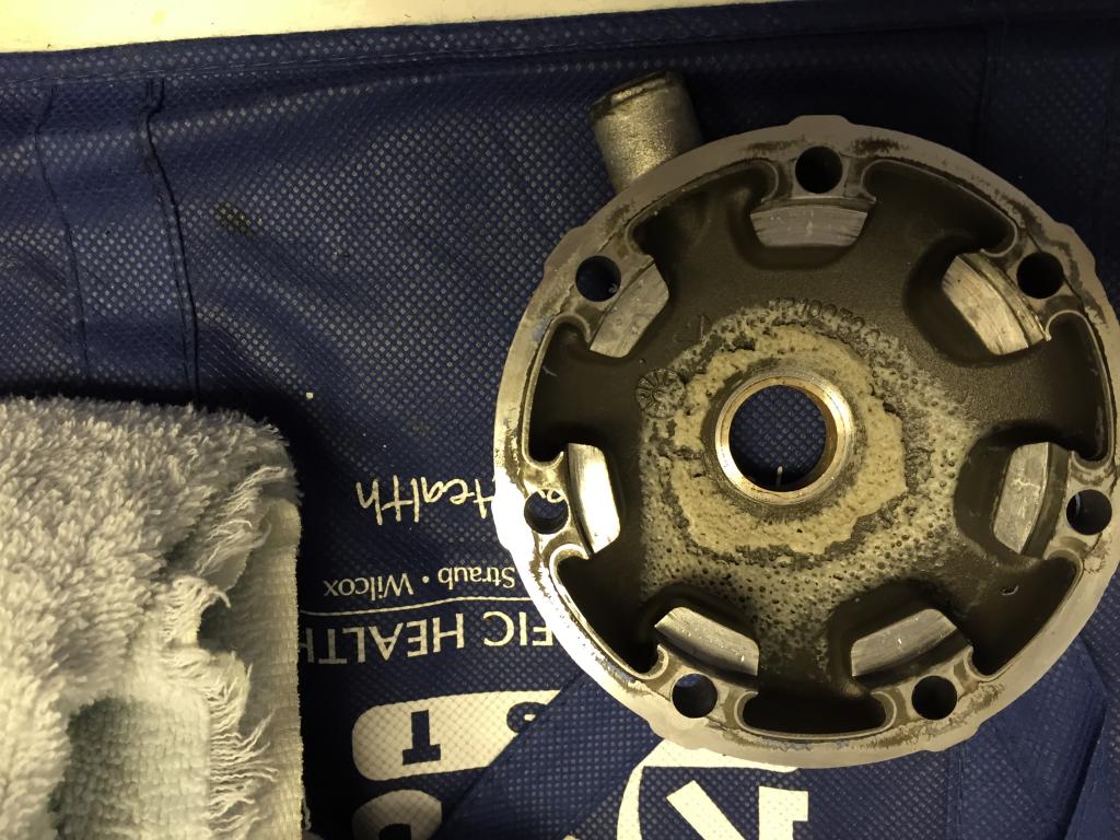

oldgrumps Posted October 6, 2015 Author Report Share Posted October 6, 2015 (edited) ok pulled the head and found the white foam goey stuff on the inside of the head cover. No obvious leaks or breaks on the gasket. The Cylinder looks good. Unfortunately I discovered a pin hole on the exterior of the cylinder. I stuck a pick inside and measured the depth of around 2.3mm. This is appears to be some kind of casting defect. The hole does not go all the way through, but wondering how close to a intake port or water jacket it is. My bike is not even 6 months old yet. Emailed Beta. Edited October 9, 2015 by oldgrumps Quote Link to comment Share on other sites More sharing options...
dan williams Posted October 6, 2015 Report Share Posted October 6, 2015 Bit more than a pin hole. I don't see anything that would indicate water or fuel/air mixture in or out of the hole. I suppose the real question is why did it overheat in the first place? If that hole went through to the water jacket the system would depressurize and over heat but it would also spew coolant. If the hole went into the transfer port you'd see spooge on the side of the cylinder and the bike would run lean causing it to overheat. I would hope that's a casting defect Beta will replace but it it isn't leaking and they don't replace the cylinder that hole should be filled with JB Weld or something similar just to make sure it doesn't start a crack or punch through to the transfer port. 1 Quote Link to comment Share on other sites More sharing options...

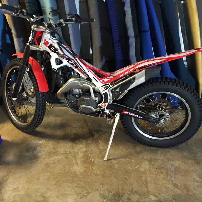

jfc Posted October 8, 2015 Report Share Posted October 8, 2015 Can you post a pic of the complete bike? Quote Link to comment Share on other sites More sharing options...
heffergm Posted October 8, 2015 Report Share Posted October 8, 2015 Call me crazy but it looks like rust at the base of the cylinder? Quote Link to comment Share on other sites More sharing options...

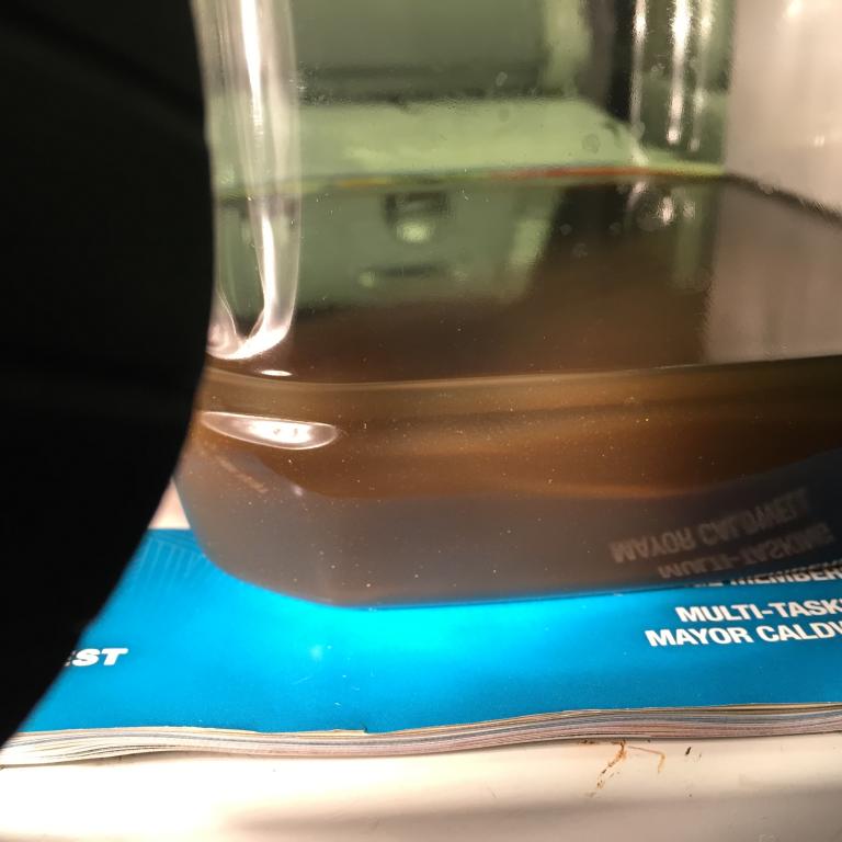

oldgrumps Posted October 9, 2015 Author Report Share Posted October 9, 2015 Sorry that is dirt where the cable shroud runs at the base of the cylinder. So I put a new head gasket cylinder in and ran the bike for 15 minutes around the block. Got it hot enough so the fan was running. Let it cool down and checked the coolant. Guess what? It still had foam sludge! So it appears the head gasket was not to blame. So thinking it might be the water pump seal I drained the oil and let it sit overnight to look for water. I don't see any water but the oil looks cloudy. Remember the oil only has 15 minutes run time on it. My friend said he thinks thats normal that the oil will not be golden brown clear after running it. The good news is that Tim Philg from betausa said they will take care of the hole in the cylinder. So I'm sure they will have to figure out whats causing the foam problem. I will post pictures of the bike and oil. Its early here in hawaii. Thanks Old Quote Link to comment Share on other sites More sharing options...
oldgrumps Posted October 9, 2015 Author Report Share Posted October 9, 2015 (edited) Ok here is the pictures. The plastic container was hard to shoot because of the thick plastic. I hope my dealer tiki cycles and betausa can get this sorted out. These make awesome trail and trials vehicles. For those of you wondering what riding in hawaii is like just checkout youtube under Sunday Rides. There is other videos of trail riding in hawaii also. Old Edited October 9, 2015 by oldgrumps Quote Link to comment Share on other sites More sharing options...
jfc Posted October 9, 2015 Report Share Posted October 9, 2015 Glad to hear that your on your way to getting it sorted. Great looking bike. The dirt around the cylinder looked really suspect. Quote Link to comment Share on other sites More sharing options...
oldgrumps Posted October 10, 2015 Author Report Share Posted October 10, 2015 (edited) OK follow up. Took the bike down to my dealer and he discussed it with Betausa. They feel there is no danger of it cracking further and there is sufficient wall thickness left. He said to just drill it and then fill it with epoxy. If the cylinder should ever crack in future they will still warranty it. Old Edited October 14, 2015 by oldgrumps Quote Link to comment Share on other sites More sharing options...
