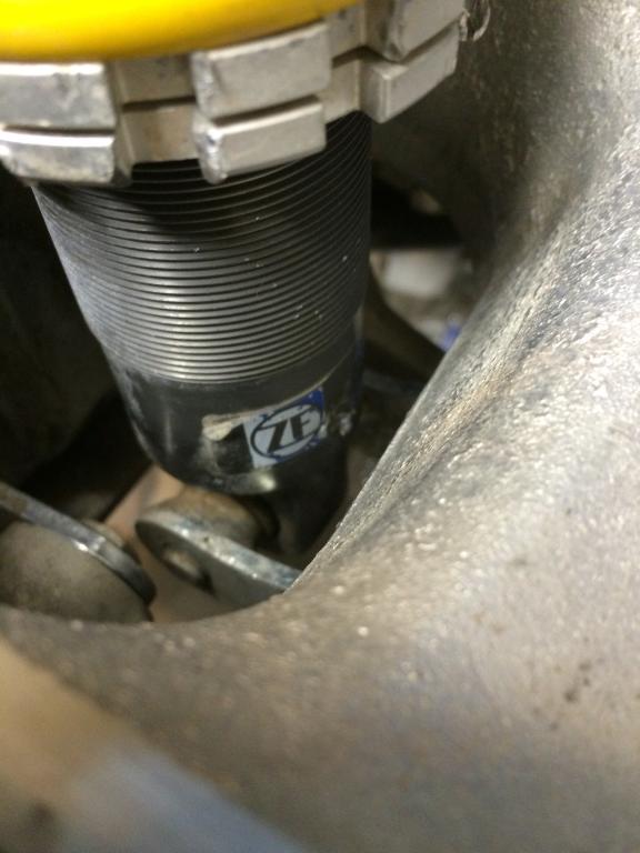

tuts Posted October 17, 2015 Report Share Posted October 17, 2015 (edited) Hello, I am looking for information about the different options I have for the rear shock. From what I've read, it seems the original is difficult to rebuild, if at all, and not the good to begin with. Any information or leads/links would be greatly appreciated. Thanks The pic is the one that I have in the bike now. But I honestly don't know what I'm looking at. Edited October 17, 2015 by tuts Quote Link to comment Share on other sites More sharing options...

tony27 Posted October 18, 2015 Report Share Posted October 18, 2015 Your shock is probably a Sachs unit, not designed to be rebuilt but can be if a filling valve is fitted I have a TRP fitted in my Jarvis which is basically a pre-production 05 & it is night & day better than the Sachs, think I ended up moving the rebound adjuster 2 clicks firmer for better traction from how it was delivered. They're really nicely made & are able to be rebuilt, you may have to take a file to the mount on the frame but the amount removed is minor & doesn't effect the strength I know I also have a later delta link fitted after I damaged the original but can't remember if it is a 06 or 07 Quote Link to comment Share on other sites More sharing options...
tuts Posted October 20, 2015 Author Report Share Posted October 20, 2015 Your shock is probably a Sachs unit...... Does the pic show what brand? Its a small pic of a label but maybe someone knows. Quote Link to comment Share on other sites More sharing options...
