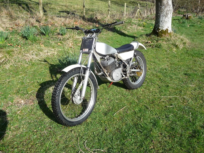

jon v8 Posted October 26, 2015 Report Share Posted October 26, 2015 As you can see I did eventually build a complete bike out of the silver frame I converted with the jig. I've done a few since and there is one which I must get on with soon... 6 Quote Link to comment Share on other sites More sharing options...

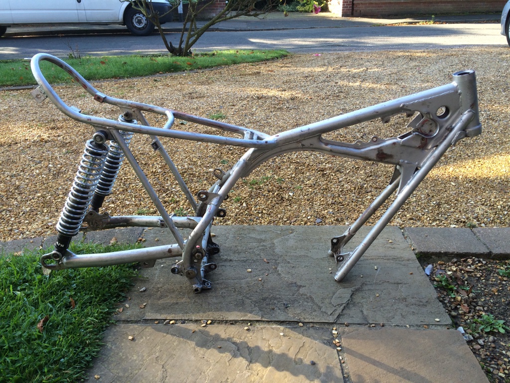

aldy13 Posted December 16, 2015 Author Report Share Posted December 16, 2015 Frame is now back and here is a before and an after pic 1 Quote Link to comment Share on other sites More sharing options...
