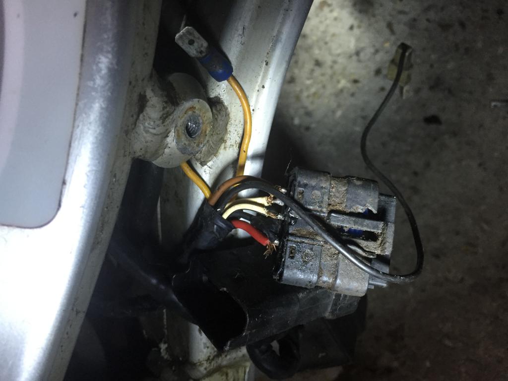

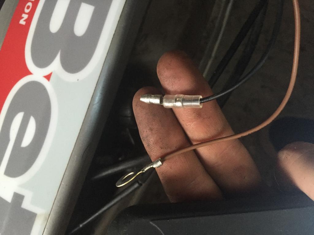

lanerpleze Posted October 24, 2015 Author Report Share Posted October 24, 2015 (edited) I really appreciate all the help guys. I'm a total newbie and I've been and bought a bit of a dog of a bike it seems. Here's a picture of the wiring I have on the bike.... It's. 1999 beta techno Dougie lampkin replica. Edited October 24, 2015 by lanerpleze Quote Link to comment Share on other sites More sharing options...

lanerpleze Posted October 24, 2015 Author Report Share Posted October 24, 2015 Yeh the whole bike has been bodged together. any one any ideas how to attach my lanyard kill switch into this loom? Quote Link to comment Share on other sites More sharing options...
rgvlc Posted October 25, 2015 Report Share Posted October 25, 2015 There will be 2 wires from the lanyard. One of them needs connecting to the black wire from the CDI the other to earth on the frame. Quote Link to comment Share on other sites More sharing options...
