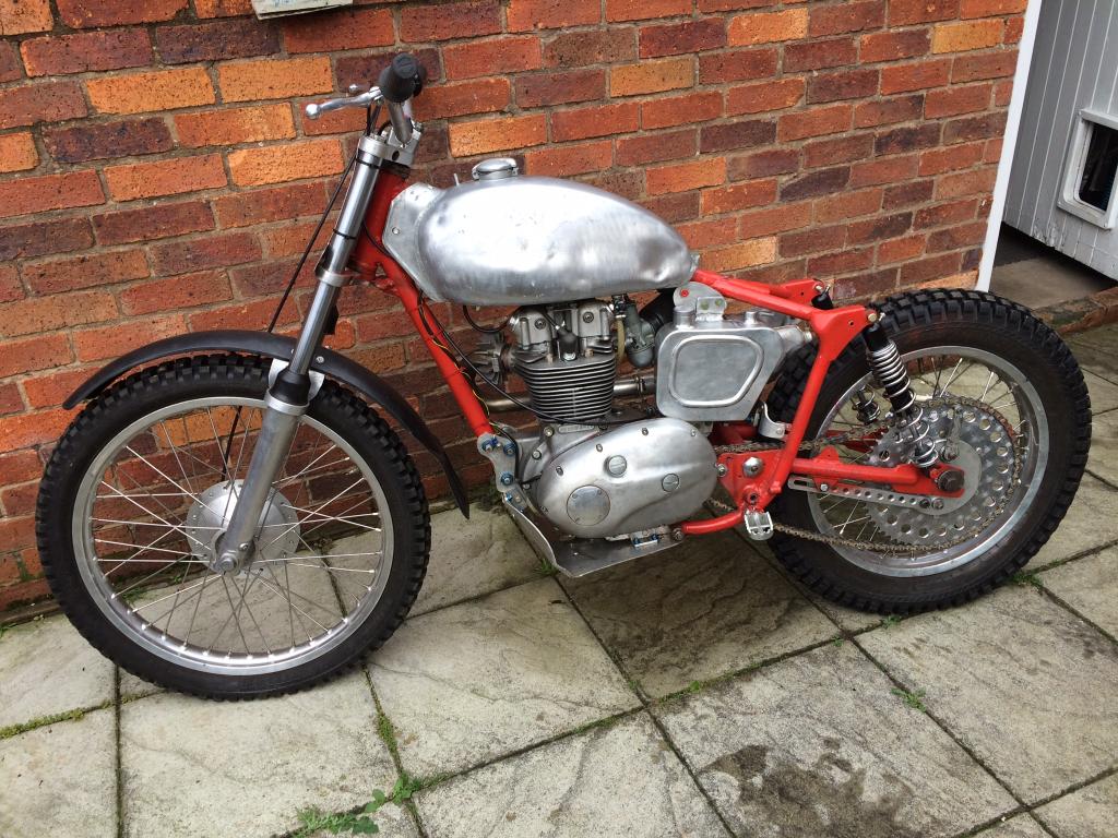

furse Posted October 31, 2015 Author Report Share Posted October 31, 2015 Looking at it again I think it has the sports swingarm 1 Quote Link to comment Share on other sites More sharing options...
bashplate Posted November 2, 2015 Report Share Posted November 2, 2015 that's one HUUUUUUGE sprocket Quote Link to comment Share on other sites More sharing options...
furse Posted November 2, 2015 Author Report Share Posted November 2, 2015 70t ! Hence the question on the gearing, it may act as a stabiliser Quote Link to comment Share on other sites More sharing options...
bashplate Posted November 3, 2015 Report Share Posted November 3, 2015 Hi Furse, looking good and can see where your coming from regards the gearing .The only other thing (s) I would be looking at is the swing arm.....a little longer, and ya bashplate looks a bit wide at the front....may be just camera angle. Motor sits in there real nice though..well done. Quote Link to comment Share on other sites More sharing options...
charlie prescott Posted November 3, 2015 Report Share Posted November 3, 2015 Hi Guy's. Hi Furse. Looking at that picture, and the sprocket. Looks like you need to go down on the engine sprocket, Not that difficult, shorter primary chain,and you will have to reduce the engine oil seal in width and machine of the surrounding alloy to suit. Check what gearbox sprocket you are running too. Hope this helps? You know where to look for further information, on one of my pages. Regards Charlie. Quote Link to comment Share on other sites More sharing options...
furse Posted November 3, 2015 Author Report Share Posted November 3, 2015 The engine sprocket is 18t, 13t on the g,box I had a 50 for the rear wheel so will try that, Charlie why do I need to machine seal etc? Thanks for replies, what is preference on oils? Quote Link to comment Share on other sites More sharing options...

davetom Posted November 4, 2015 Report Share Posted November 4, 2015 Interesting comments by Deryk re sprocket size affecting grip . Squat will increase with smaller sprockets but there's more to it than that as swingarm length, shock length, Spring strength and ride height are all factors too. A certain amount of squat is useful, but too much isn't good either so I'd be interested if anyone's done any recent comparisons, especially as bikes are lighter, softer sprung and have more travel than they did back in the day ? Quote Link to comment Share on other sites More sharing options...
furse Posted November 4, 2015 Author Report Share Posted November 4, 2015 Ah understand know, Cheers B40rt. Just looked is has been done. 1 Quote Link to comment Share on other sites More sharing options...
