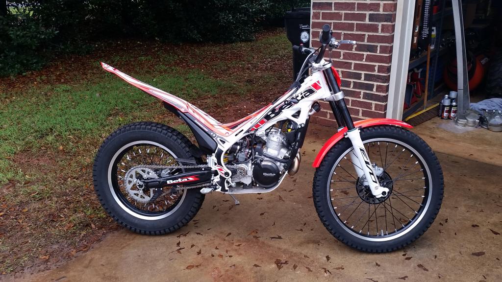

Pulled the trigger on a 2015 Evo 300 standard, my dealer had a minders bike from the Worlds that were recently held at Stepping Stone. Only has about 8 hrs on it with a small scratch on the swing arm. Got it at a great price. I rode it for a short bit and found the suspension amazing and the power is not overwhelming. Dealer is installing slow throttle with the thick grips and ARC levers.
Thanks again for all the excellent advice!

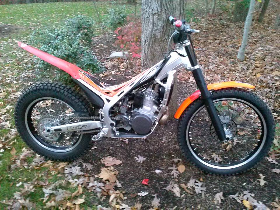

I was fortunate enough to get ifixfords "old" 2009 Beta EVO 250.  It is my first modern trials bike (I have an '86 Reflex).
I rode it last weekend and it was an amazing machine.  I'm glad ifixfords upgraded!
