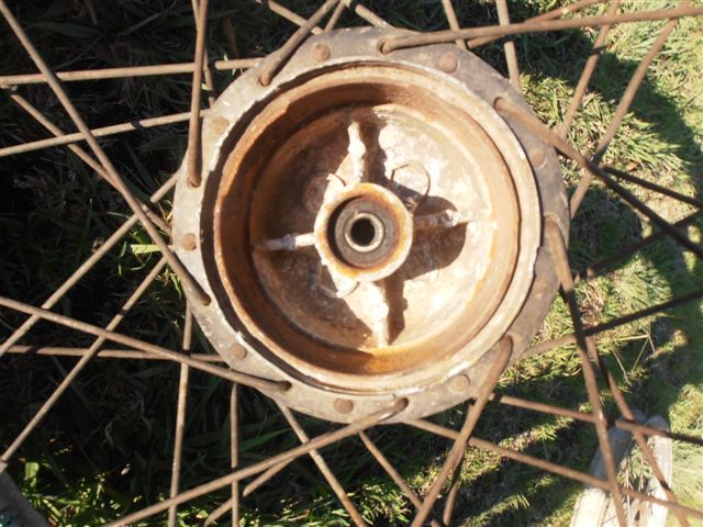

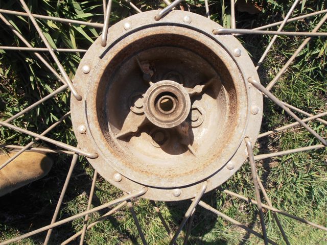

jc2 Posted November 12, 2015 Report Share Posted November 12, 2015 (edited) Gents, can anyone recognize this Ossa front hub in the top pic? 122mm dia. Please note that there is no groove around the outside the brake liner. (Other 122mm Ossa super pioneer hubs I have have such a groove - as in bottom pic) Perhaps a Mk1 MAR ?? cheers Edited November 13, 2015 by jc2 Quote Link to comment Share on other sites More sharing options...
feetupfun Posted November 12, 2015 Report Share Posted November 12, 2015 John what is that light coloured thing visible through the bearing hole? Quote Link to comment Share on other sites More sharing options...
woody Posted November 12, 2015 Report Share Posted November 12, 2015 Is it just the light from the other end, looks odd as the bearing spacer is tilted? MAR doesn't have those raised bits in the castings for the nut retainers and bearing housing looks different (from the photo at least) Quote Link to comment Share on other sites More sharing options...
2stroke4stroke Posted November 12, 2015 Report Share Posted November 12, 2015 (edited) My MAR did have the raised bits - it appeared the front and rear hubs were the same basic casting machined to suit. Edited November 12, 2015 by 2stroke4stroke Quote Link to comment Share on other sites More sharing options...
jc2 Posted November 13, 2015 Author Report Share Posted November 13, 2015 (edited) I have edited my 1st post & added a pic of the more common hub (bottom pic). Notice the groove around the outside of the brake liner that the top one does not have. The top hub has 122.600M cast in. The bottom one has 122.600BM I managed to find ossa parts diags on the net - thanks ossaworld - & 72MAR has 122.600M whereas later MAR has 122.600BM. Diff brake plate for each, as you would expect from above pics, so mystery solved I think. Edited November 13, 2015 by jc2 Quote Link to comment Share on other sites More sharing options...
