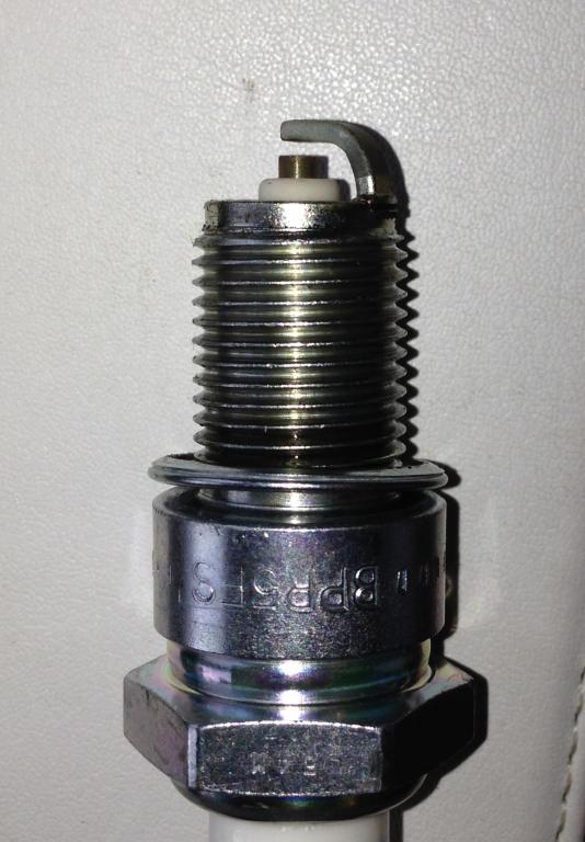

sean65 Posted November 22, 2015 Author Report Share Posted November 22, 2015 TXT 280 2001. PHBL 26 Dellorto BPR 5ES as recommended. New to trials and 2 strokes. I know the reeds help with fuel/air mix. Could the be effecting the running? If I get around to starting again later I will take a short video. Quote Link to comment Share on other sites More sharing options...
sean65 Posted November 22, 2015 Author Report Share Posted November 22, 2015 Rode around the block a few times with this plug in. Very very clean. Fueling? Quote Link to comment Share on other sites More sharing options...
b40rt Posted November 22, 2015 Report Share Posted November 22, 2015 http://www.google.co.uk/search?ie=UTF-8&source=android-browser&hl=en-GB&q=pictures+spark+plugs+colours&gfe_rd=cr&ei=U8BRVrPENIPj8wfXkIlI#gfe_rd=cr&imgrc=gTNHqHWopVgXaM%3A Quote Link to comment Share on other sites More sharing options...
sean65 Posted November 22, 2015 Author Report Share Posted November 22, 2015 Seem ok then considering how short a journey was made. Stuck an old one in just for comparison. Quote Link to comment Share on other sites More sharing options...

mcman56 Posted November 22, 2015 Report Share Posted November 22, 2015 In my experience sputtering usually means rich fuel mixture. In the video, it also looked like there was a little black smoke which also means unburned fuel. Was the old plug black? Is the air filter clean? Did the bike previously run well with the current carb settings? (jets, needle position, etc.) Dirt in the system will usually create lean conditions not rich. From what you say, it cleans out at higher rpms. It could be a leaky float needle/ seat or improperly adjusted float. It certainly does not sound like a weak spark but a fully retarded timing may possibly do some thing like that. Could the stator place have come loose and changed the timing? Quote Link to comment Share on other sites More sharing options...
