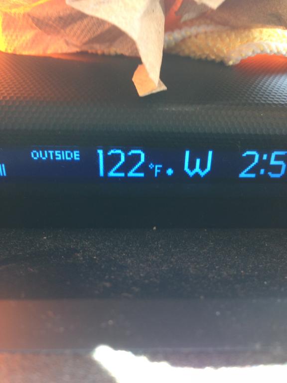

billyt Posted November 24, 2015 Report Share Posted November 24, 2015 (edited) The picture is from my Toyota 4 Runner dash. This is pretty typical temps here (Scottsdale AZ) in summer. Installing a bigger rad alone does not help as the engine oil temp is a bigger problem affecting shifting, transmission, clutch etc. An oil cooler is required for 4T engine longevity in really warm/hot weather. Edited November 25, 2015 by billyt Quote Link to comment Share on other sites More sharing options...
