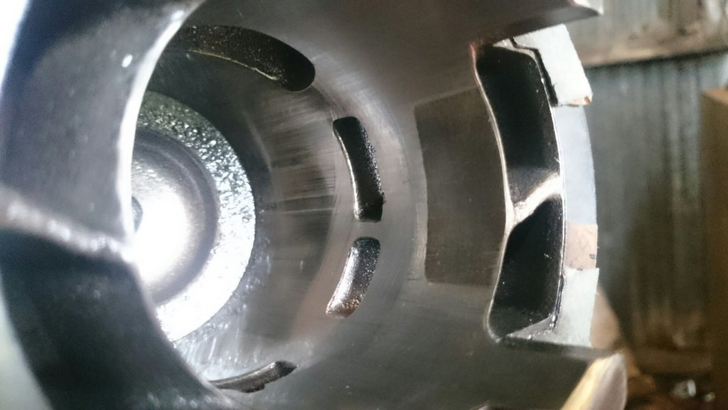

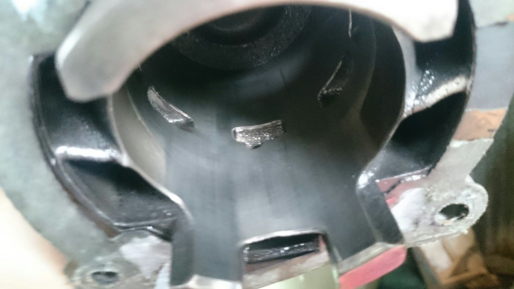

alscott1984 Posted November 23, 2015 Report Share Posted November 23, 2015 Hi all, as you can see from my post title my bike has died, A sorry attempt at taking up a sport if ever there was one. Whilst on my first day ride out at Kinnerstons farm, Llangollen, the engine made a few funny clicks followed by fast tapping. Turns out small bits chipped of the edges of the ports, scored the side of the piston then got smashed against the head for a few seconds before dying. lost compression etc. Problem seems to be finding a replacement barrel/piston/head. Its an old bike and the odd similar parts i've seen are asking for silly money (£170 for a barrel). Does anyone know if i can fix it some how cheaper, re line the barrel etc. Failing that would anyone know if its wort breaking or what value to a breaker. I need something back from it to put to a newer bike but as it is its sitting doing nothing. Any idea/ comments would be appreciated. Cheers, Al Quote Link to comment Share on other sites More sharing options...

alscott1984 Posted November 24, 2015 Author Report Share Posted November 24, 2015 So do you think the barrel would be useable with the little chips in the ports? A new piston kit is around 140 quid if i can get hold of one. The head might do as well. I thought the chips would render the barrel useless? I was trying to put pics of the barrel on but cant figure out how to ha ha Quote Link to comment Share on other sites More sharing options...

alscott1984 Posted November 25, 2015 Author Report Share Posted November 25, 2015 figured out how to add pics so here it is, note the chips missing from the bottom edges of a few of the ports?!?! Quote Link to comment Share on other sites More sharing options...

twinshock giles Posted November 26, 2015 Report Share Posted November 26, 2015 IF (and its a big IF) the plating on the barrel is ok - I couldn't make up my mind from the photos and you are on a tight budget, I would be tempted to smooth out the chips and try to get hold of a used piston and stick it in with new rings, they shouldn't catch the rings where they are. It would probably be ok for a good while as long as you don't let it scream out or try to do the SSDT Check the edges of the other ports for any sharp edges too. Also check the bottom end for any broken bits of piston, most of the time stuff just goes out the exhaust port but there is always a chance... Quote Link to comment Share on other sites More sharing options...
lineaway Posted November 26, 2015 Report Share Posted November 26, 2015 The chip is not going to stop it from running, but what did come apart? A lot of metal chips in the head. Mains? Rod Bearing? Something happened. Quote Link to comment Share on other sites More sharing options...
