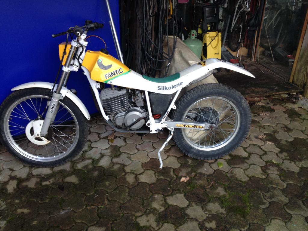

fanticfan Posted November 28, 2015 Report Share Posted November 28, 2015 Hi all, just wondering if anyone has had any headlight issues ? recently bought a 307 in pretty good condition used it a few times and the headlight has stopped working. Took the bulb out and checked that then put a tester on and no power to it. there is a small black box under the tank is there a fuse inside? Any help or pointers would be greatly received. Thanks Quote Link to comment Share on other sites More sharing options...
lineaway Posted November 28, 2015 Report Share Posted November 28, 2015 I would check the handlebar switch, but if it was mine I would remove it. 1 Quote Link to comment Share on other sites More sharing options...
reggie Posted November 28, 2015 Report Share Posted November 28, 2015 I thought the 307 had USD forks Quote Link to comment Share on other sites More sharing options...
steve_earle Posted November 28, 2015 Report Share Posted November 28, 2015 Nice bike but looks a bit odd ball, Should have Alloy Swingarm, Alloy Subframe, Disk rear wheel and USD forks for a 307. The frame also looks different around the footpeg mounts. Back to the headlight issue, It could be the regulator that limits the voltage gone a.k.a black box, Check voltage from the stator side with the bike running. Also could be an earth issue. Quote Link to comment Share on other sites More sharing options...
collyolly Posted November 29, 2015 Report Share Posted November 29, 2015 Back wheel and swing arm from a 301 ? Quote Link to comment Share on other sites More sharing options...
alberto Posted November 29, 2015 Report Share Posted November 29, 2015 It's a Fantic Coach not a 307 Quote Link to comment Share on other sites More sharing options...
fanticfan Posted November 29, 2015 Author Report Share Posted November 29, 2015 I did contact Bob Wright and sent him a few photos and he seemed to think it was the 307. I will try testing the black box I did check the connections and all was pretty clean. Quote Link to comment Share on other sites More sharing options...
steve_earle Posted November 29, 2015 Report Share Posted November 29, 2015 It is a coach, I just googled it!, Based on the 5 and 7 series bikes, I've never seen one here in the U.K. I've heard of the clubman though. Quote Link to comment Share on other sites More sharing options...
fanticfan Posted November 30, 2015 Author Report Share Posted November 30, 2015 I think your right Steve I had a look last night and looks pretty much like the coach. I'm over in the south of France and the bike has come from over the border in Italy. Not seen any others about over here, but it's a pretty cool bike and runs really good. Quote Link to comment Share on other sites More sharing options...
motopelli Posted December 4, 2015 Report Share Posted December 4, 2015 I agree it's a coach. The tabs on the rear of the frame were for passenger pegs! Quote Link to comment Share on other sites More sharing options...
