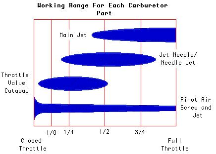

klonheadd Posted October 11, 2017 Report Share Posted October 11, 2017 (edited) On 10/11/2017 at 11:11 AM, trapezeartist said: Some people have suggested to me that I should use 127.5 main jet but 120 seems to be working fine for me. Expand Hey, you might be missing on some top end kick. The adjustment on Air/Fuel screw will help to richen the mixture but will not affect top end/full throttle that much. I haven't tested it with stock silencer, but with my current setup which is Arrow pipe ,changing main jet from 120 to 127.5 made BIG impact to the top end power. Edited October 11, 2017 by klonheadd 1 Quote Link to comment Share on other sites More sharing options...

trapezeartist Posted October 12, 2017 Report Share Posted October 12, 2017 On 10/11/2017 at 1:41 PM, klonheadd said: Hey, you might be missing on some top end kick. The adjustment on Air/Fuel screw will help to richen the mixture but will not affect top end/full throttle that much. Expand With my riding skills, top end power is of negligible interest. My main concern is "driveability". I would like to think that my riding is getting better, so it can be easy to confuse improvements to the bike and improvements to the rider. Nevertheless a slow throttle, adjusting the slow-running mixture, adjusting the idle speed and (possibly) sorting out the breather pipes have been the things that have brought the improvements. Quote Link to comment Share on other sites More sharing options...
klonheadd Posted October 12, 2017 Report Share Posted October 12, 2017 (edited) On 10/12/2017 at 12:36 PM, trapezeartist said: With my riding skills, top end power is of negligible interest. My main concern is "driveability". I would like to think that my riding is getting better, so it can be easy to confuse improvements to the bike and improvements to the rider. Nevertheless a slow throttle, adjusting the slow-running mixture, adjusting the idle speed and (possibly) sorting out the breather pipes have been the things that have brought the improvements. Expand Fair enough. Although in my case the changes equaled better "driveability", and more fun. I really like the this engine and it only shines more when it's "un-corked". You always have the throttle to control it but.... I have to say I managed to break 2 fenders on first 2 practices after jet changes haha. Edited October 12, 2017 by klonheadd Quote Link to comment Share on other sites More sharing options...
