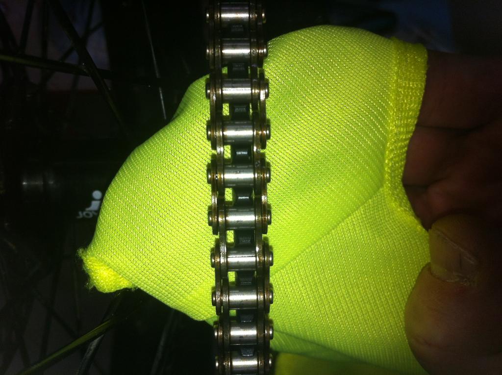

gilles Posted December 17, 2015 Report Share Posted December 17, 2015 (edited) Hello guys, I bought a new "upgrade" chain kit for my 2011 oset 16". So bigger chain. The shop confirms me its OK but I doubt that there is to much play between chain and chainring. The owner isn't in till next week so I cant double check with him. Could any of you please check if it is the same on a new model Oset 16"? See pic and movie https://youtu.be/nnnaTCFe8kc Big thanks! Edited December 17, 2015 by gilles Quote Link to comment Share on other sites More sharing options...
basil Posted December 17, 2015 Report Share Posted December 17, 2015 Just purchased a new 16 yesterday nothing like the movement on ours Dealer said chain was 9mm Quote Link to comment Share on other sites More sharing options...
basil Posted December 17, 2015 Report Share Posted December 17, 2015 Further to the above the Oset handbook for the latest 16 Eco and Racing models state 219 chain. also stamped on our links is 219 SH Hope this assists you Quote Link to comment Share on other sites More sharing options...
