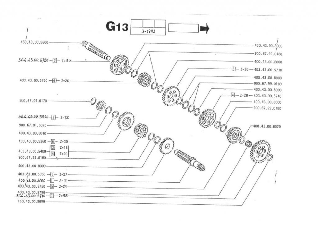

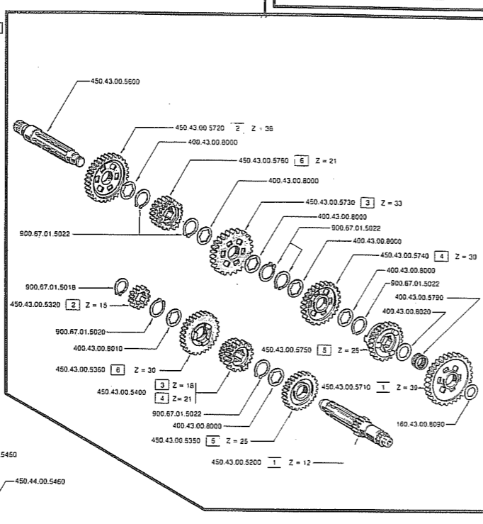

elsimonell Posted December 17, 2015 Report Share Posted December 17, 2015 if anyone knows, maybe .. or transmission of Fantic Fantic 212 FM 363 k k-roo roo can be used in the engine FM450 Fantic Trial 240. Quote Link to comment Share on other sites More sharing options...
elsimonell Posted December 17, 2015 Author Report Share Posted December 17, 2015 (edited) I answer himself. yes - it fits. Gear ratios are different but everything beyond the same. Edited December 17, 2015 by elsimonell Quote Link to comment Share on other sites More sharing options...
grib Posted December 17, 2015 Report Share Posted December 17, 2015 It will fit but the spline on the clutch hub is different. You could use the clutch from the later engine too but you would also have to use the cover and the primary drive pinion would need a keyed bush to fit on the crank, I think. 1 Quote Link to comment Share on other sites More sharing options...
lee harris Posted December 18, 2015 Report Share Posted December 18, 2015 No, it will not fit. Grib is right but the primary drive wont fit the 240 crank. 240 lhs bearing is oiled from gearbox. Like gas gas pro. Quote Link to comment Share on other sites More sharing options...
