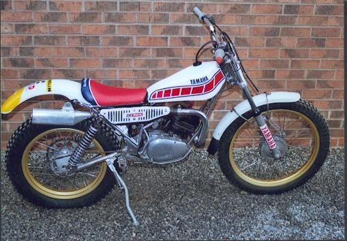

johnnyboxer Posted October 13, 2005 Report Share Posted October 13, 2005 This is mine and was made in Jan 1982 (confirmed by John Shirt in dating letter) I think frame is nickel plated,rather than chromed Obviously some mods have been made from original spec (wheel rims and tank has been repainted & red graphics added) but it's mainly stock Quote Link to comment Share on other sites More sharing options...
