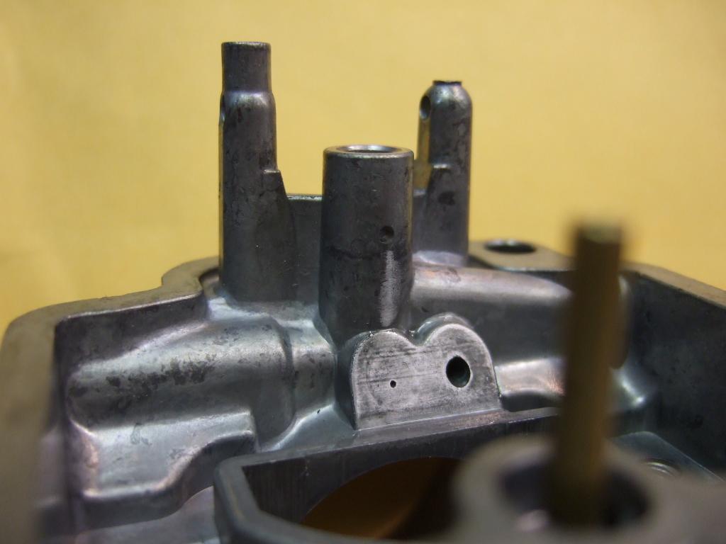

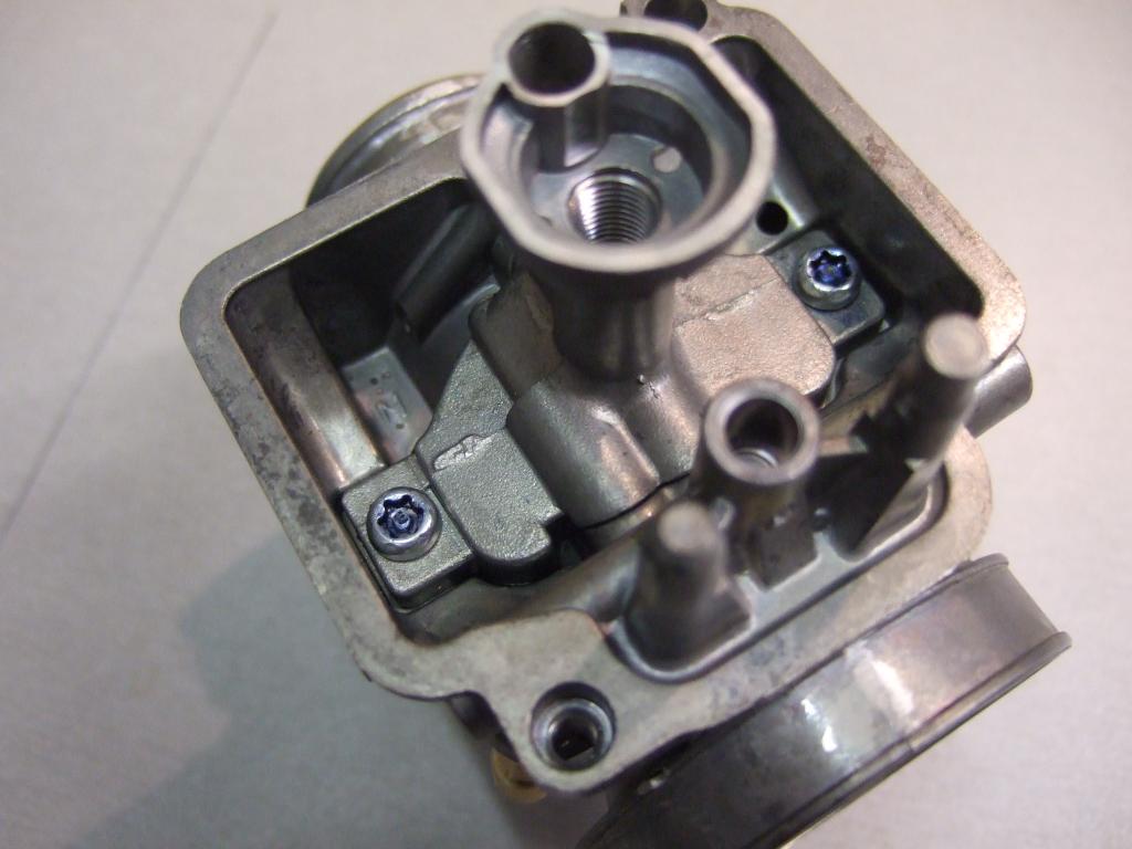

steve_earle Posted January 3, 2016 Report Share Posted January 3, 2016 When you take the carb apart remove the jet tower that's held in place with 2 tamper proof torx screws. There is a rubber gasket in there and one side is glued to the jet tower. I have seen one with excess glue that was blocking one of the passages. Quote Link to comment Share on other sites More sharing options...
redhubuk Posted January 4, 2016 Report Share Posted January 4, 2016 When you take the carb apart remove the jet tower that's held in place with 2 tamper proof torx screws. There is a rubber gasket in there and one side is glued to the jet tower. I have seen one with excess glue that was blocking one of the passages. Had these images to hand, I think it shows what steve_earle recommends. Quote Link to comment Share on other sites More sharing options...
