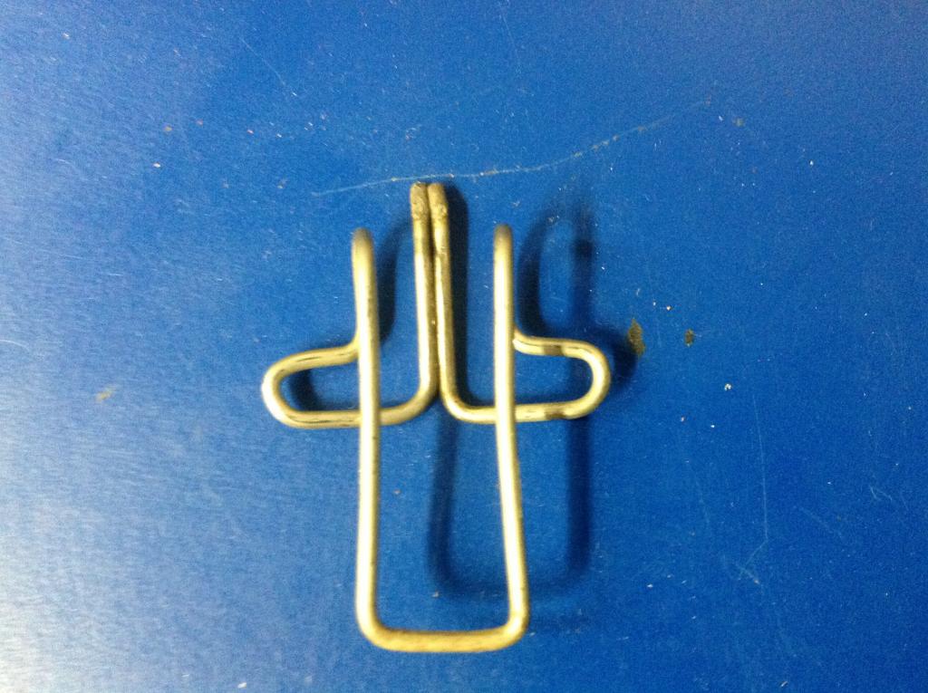

jfc Posted January 9, 2016 Report Share Posted January 9, 2016 Is anyone running with the clip removed like this- Clip- Quote Link to comment Share on other sites More sharing options...
huski Posted January 9, 2016 Report Share Posted January 9, 2016 Why remove it? Quote Link to comment Share on other sites More sharing options...
jfc Posted January 9, 2016 Author Report Share Posted January 9, 2016 Seems to have a tendency to cause the pads to drag slightly, and speaking to another rider they said that thay had removed it without any problems and the drag disappeared,. On fitting new pads today I just left the clip out to see how it ran, the shape of the pad will not allow them to move from the correct position. Quote Link to comment Share on other sites More sharing options...
strengthcoach Posted January 9, 2016 Report Share Posted January 9, 2016 Seems to have a tendency to cause the pads to drag slightly, and speaking to another rider they said that thay had removed it without any problems and the drag disappeared,. On fitting new pads today I just left the clip out to see how it ran, the shape of the pad will not allow them to move from the correct position. That's interesting JFC. I have this same brake and it's been draggy at times and has driven me nuts. I could not for the life of me figure out why it dragged. Maybe I'll remove the clip and see if that helps. Please keep us updated. Dan Quote Link to comment Share on other sites More sharing options...
huski Posted January 9, 2016 Report Share Posted January 9, 2016 I've had the same problem,think I'll try removing it too,as you say the pads can't come out Quote Link to comment Share on other sites More sharing options...
jfc Posted January 9, 2016 Author Report Share Posted January 9, 2016 After some searching around the internet it would appear as the post title states that it is just the brake pad RETAINING clip so its probably put in there for a bit of a laugh by BRAKTEK ...... those kids. Thanks! Quote Link to comment Share on other sites More sharing options...
sherpa325 Posted January 10, 2016 Report Share Posted January 10, 2016 Most likely an anti-rattle clip Quote Link to comment Share on other sites More sharing options...
baldilocks Posted January 10, 2016 Report Share Posted January 10, 2016 Friend of mine rang gas gas uk as he was struggling to re fit the clip. They said they don't use them just chuck it. 1 Quote Link to comment Share on other sites More sharing options...
crazybond700 Posted January 10, 2016 Report Share Posted January 10, 2016 I think its to prevent fibration and so noice. Its not necessary in my opinion. 1 Quote Link to comment Share on other sites More sharing options...
jfc Posted January 10, 2016 Author Report Share Posted January 10, 2016 Thank you for all the constructive replies, been out today with my son practicing and no problems, no noise or vibration and most importantly no drag. Quote Link to comment Share on other sites More sharing options...
huski Posted January 10, 2016 Report Share Posted January 10, 2016 Removed mine,rode today with no problem,will leave it off .Used to drag with it fitted,seems to pull the pads into constant contact,the wheel turns much freer without it 1 Quote Link to comment Share on other sites More sharing options...
faussy Posted January 17, 2016 Report Share Posted January 17, 2016 Interesting topic. Mine was dragging, thought it was just due to badly worn pads at an angle and the pistons sticking. New pads seemed to fix it but ill keep my eye on it. I agree though, as long as the disk is there its impossible for the pads to come out. Quote Link to comment Share on other sites More sharing options...
sting32 Posted February 11, 2016 Report Share Posted February 11, 2016 I bet, that when you will take the front wheel off, and the pads could then fall out of the caliper, I imagine... I haven't tried it yet, that would be my only worry, and you will just have to put the pads back in and hold them, as those pads dont have the screw that holds the pads in place like rear brakes and older brakes, as far as I know. But, that is all the spring is for, I think, keeping the pads in when the disc is not present. Time will probably tell if they can fall out when pads get too thin? Quote Link to comment Share on other sites More sharing options...
buschog Posted August 17, 2018 Report Share Posted August 17, 2018 Revival of an old topic. How did it turn out leaving the retainer out. I have a 2015 280 pro. I was trying to learn how to get the clip back in all the way correctly. But if I don't need it in there at all, I won't bother with it. Quote Link to comment Share on other sites More sharing options...
mbeers6 Posted August 18, 2018 Report Share Posted August 18, 2018 I couldn't get the clip back in on my '17 250 so left it out. That was several months ago and no issues. What people said about is probably correct, it's there to keep the pads from dropping out when removing the caliper. Quote Link to comment Share on other sites More sharing options...
