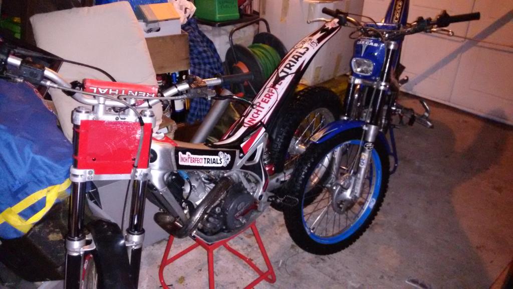

english electric Posted January 11, 2016 Author Report Share Posted January 11, 2016 forgot to post picture derrrrr Quote Link to comment Share on other sites More sharing options...
