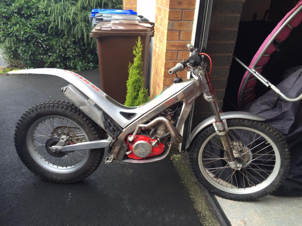

sr1murray Posted January 19, 2016 Report Share Posted January 19, 2016 Hi, been having a flick through as I'm a newbie, not only to this site but trials in general. I've been to see a few trials and joined the ACU as well as a local club. I've got hold of a bike, a 1996 Gas Gas 250 Contact. It's rough around the edges but was blooming cheap! Only problem is, I can't get the bugger started! I've started at the carb, cleaning all the gunk, sand and rubbish out. Checked there's a spark which there is. Cleaned all the rubbish and mud from all I can see wiring wise. But still can't even get a splutter. With the plug out I set the engine to bottom dead centre (screw driver down the barrel) and squirted in some easy start (straight into the barrel as well as the carb) but on replacing the spark plug there still wasn't so much as a cough. Reading up on what I can find on the Internet I've even tried checking the spark with a second plug in the head to create compression - there is still a good spark. I have no idea where to go from here, any help would be greatly appreciated! I've attached a photo of the bike. Thanks. Quote Link to comment Share on other sites More sharing options...

sr1murray Posted January 19, 2016 Author Report Share Posted January 19, 2016 Does this photo help identifying the year/model? Quote Link to comment Share on other sites More sharing options...
