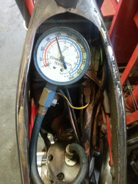

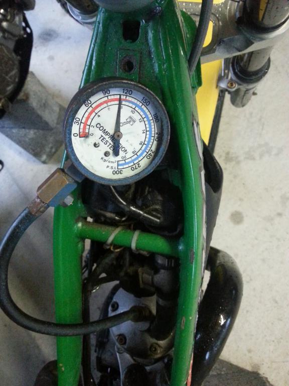

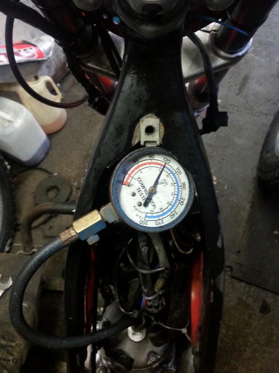

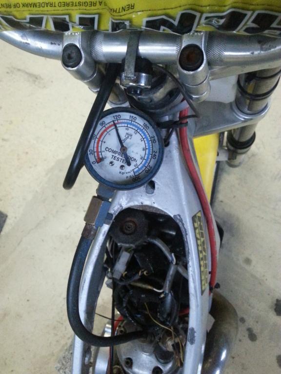

renegade master Posted January 31, 2016 Author Report Share Posted January 31, 2016 Ok got to work on the bike for a shoet time today, So I changed the fuel tap for a working one off a txt pro i had spare, I done the compression test too, now not sure if i tested it right or if the tester was working right eather so this was how i done it, took out plug and screwed in tester, then got TDC and kicked and got reading, then repeted 3 times to see if i got the same readings, heres what i got (TXT270 1998) compression test so while I had the plug out i gave it a few kicks to see, and yeah think there was slight petrol mist comming from head, so after that put plug back in and it started eazy! So guys i havent a clue about what it says on the compression gauge? but I tested some of my other bikes too, so it would give me a idea so here is the others i tested This is the TX270 (1998) This is the TXT pro (2004) This is the JTX270 (1997) The compression tests kinda seem all the same or close as, wonder if the tester is working right? Quote Link to comment Share on other sites More sharing options...

lineaway Posted January 31, 2016 Report Share Posted January 31, 2016 That`s enough to start the bike easily with the kick starter. And yes a flooded bottom end will make your life miserable. You should be on the right track. Quote Link to comment Share on other sites More sharing options...
