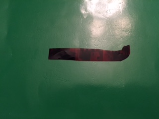

oldgrumps Posted February 1, 2016 Author Report Share Posted February 1, 2016 (edited) Thanks guys. I realigned the forks but oil was still weeping. It's Sunday so all the shops are closed. Decided to make my own tool out of film negatives. Made a few passes when I noticed the tip of the tool was broken off! Now I was really upset! Cut out a few more tools and made about 50 passes but could not get anything to surface. Not sure if it's stuck why down in the seal or where it went??? Put the bike back together and the seal is not leaking anymore. I'm not going to worry and just ride it! Old Edited February 1, 2016 by oldgrumps Quote Link to comment Share on other sites More sharing options...
