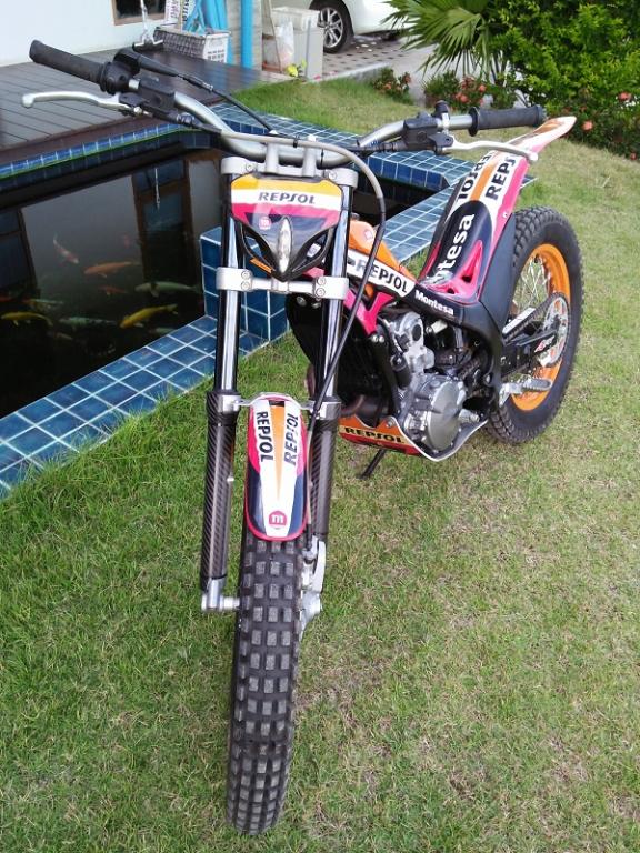

menglovekai Posted February 2, 2016 Report Share Posted February 2, 2016 (edited) Hi .I just got a 20hr of 2011 4RT Repsol from my friends The bike is in near perfect condition , I did all the oil change , spark plug changed , valve clearance checked , coolant level checked.It is very easy to start when cold .normally 1-3 slow and smooth kick. ( But when engine get hot after 1 hour of continuous practice (mostly short hill climbing, crossing gaps,trackstand) no sign of sluggish during ride at all. but If the motor stop it won't start again. I did reset the ECU , check the plug (spark and dry) , no smell of gas when start . still cannot start.engine sometime fireup for a few stroke and die . not touch the throttle. Air temperature 30 degree C, I have to wait 10 minutes and the motor start at the first kick . Do you have any experience why i can not do the hot start? Thanks.(I'm not good in English but i try to explain) Edited February 2, 2016 by menglovekai Quote Link to comment Share on other sites More sharing options...

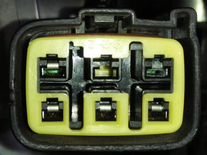

menglovekai Posted February 2, 2016 Author Report Share Posted February 2, 2016 Took the coil out , the Ground wire and clean. then the Rectifier connector , I notice the white rusty thing on the Red cable pin which supply the 12 V to the system.so i clean and WD-40 it a bit.I will post the result soon. thanks. Quote Link to comment Share on other sites More sharing options...

menglovekai Posted February 3, 2016 Author Report Share Posted February 3, 2016 (edited) This is what i have done yesterday .1. Change spark plug .2. Check and Clean all connector (Found 1 pin dirty at the Rectifier)3. Turn Aircrew out 1/8 turn to increase the Idle. I can sometimes start the engine when hot . But when the problem occured , the engine run for a 1-2 seconds and stop ( which manual say it was about the bank angle sensor )but if i wait about 5-10 minutes .It start normally. Next step I will bypass the bank angle sensor. Thanks for your suggestion. Edited February 3, 2016 by menglovekai Quote Link to comment Share on other sites More sharing options...
