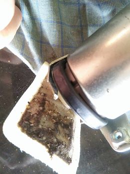

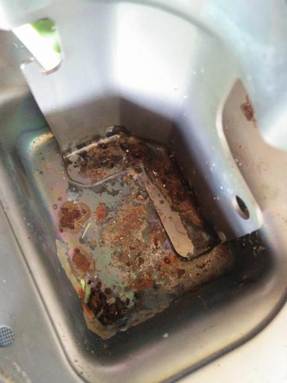

menglovekai Posted August 12, 2016 Author Report Share Posted August 12, 2016 Eventually, I found the problem .The Fuel filter was clogged by rust . After flush and clean the filter , Now the bike can hot start everytime no matter how hot the weather is. The root cause may be the crack fuel cap ,So the water can get in when washing the bike and after parking for almost 2 years.the rust buildup. Thankyou everyone. 2 Quote Link to comment Share on other sites More sharing options...
guys Posted August 17, 2016 Report Share Posted August 17, 2016 I've heard from this rust problem before, but didn't thought of it to link it to hot start problems. To avoid that problem, I had an aluminium tank bottom on my 2008 4RT (also saves a bit of weight). I also use Shell V-Power for that reason: less ethanol in the fuel = less water in fuel = less rust and other water related problems in fuel system. Honda finally addressed this problem with a plastic fuel tank bottom. Quote Link to comment Share on other sites More sharing options...
