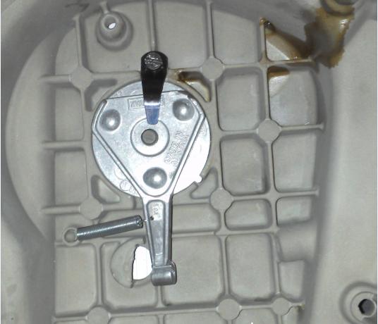

brownie001 Posted February 12, 2016 Report Share Posted February 12, 2016 Hi, has anybody out there had any experience with this type of clutch actuator ? Does it make a big difference or none at all to the lightness of the clutch ? 1 Quote Link to comment Share on other sites More sharing options...
motoswm Posted February 12, 2016 Report Share Posted February 12, 2016 Yes...worth having a noticeable improvement over the standard 1 Quote Link to comment Share on other sites More sharing options...

brownie001 Posted February 12, 2016 Author Report Share Posted February 12, 2016 (edited) FYI, the arm, spring, retaining plate and ball bearings are all Aprilia parts, it just the round plate at the back which sits on the original ramp tops (this is not true, check out the Barnett clutches thread for the documented pictures) in the casing which has been specially made. It also has ramps cast into it for the three large ball bearings. AP0259325 that's the part number for the arm b.t.w. Yes indeed, the site is full of interesting stuff, glad you like it, hope you find what you're looking for too. Tschau, Phil Edited March 10, 2016 by brownie001 1 Quote Link to comment Share on other sites More sharing options...

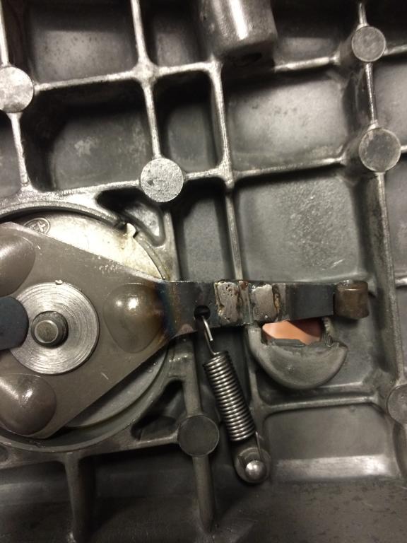

robbiesty175 Posted March 9, 2016 Report Share Posted March 9, 2016 A friend is working on my Rotax powered Can-Am 240 trials bike and discovered this gem today!!! Looks like a custom job to smooth out the clutch just a bit. I've yet to even see OR ride this bike yet, so excited to try it out. All feedback is welcome! Quote Link to comment Share on other sites More sharing options...
brownie001 Posted March 9, 2016 Author Report Share Posted March 9, 2016 Now that's interesting. The arm you have is made of steel and has been lengthened by probably 10 mm. That was a well known mod on the original actuator arms. The one I have, which is an Aprilia part, is diecast ally, so a little more difficult to extend if required. There certainly are more than one way to skin a cat ! 1 Quote Link to comment Share on other sites More sharing options...

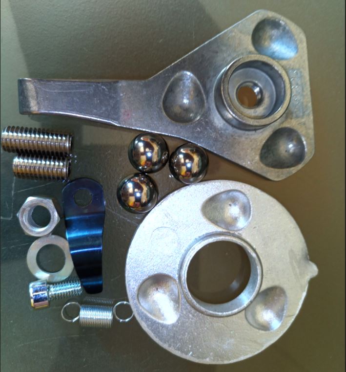

brownie001 Posted August 28, 2018 Author Report Share Posted August 28, 2018 Hi basinbaker2, if you are going for the conversion but keeping the original SWM casing, the ramps need to be milled off and a special plate with cast in ramps is required. When I finally got hold of mine from Italy, I had a few cast if you are interested. In fact, just checked, I have all the bits for two complete conversions plus 3 more cast plates and various adjuster screws and 12 mm balls. PM me if you are interested. Phil 1 Quote Link to comment Share on other sites More sharing options...
brownie001 Posted September 1, 2018 Author Report Share Posted September 1, 2018 Here are the parts required. 1 1 Quote Link to comment Share on other sites More sharing options...
petert Posted October 6, 2018 Report Share Posted October 6, 2018 On 9/1/2018 at 11:13 AM, brownie001 said: Here are the parts required. How much are you wanting for the complete kit? Is it just a direct replacement for the stock one BTW? Quote Link to comment Share on other sites More sharing options...
dozerash Posted October 6, 2018 Report Share Posted October 6, 2018 I’m interested too! Can the parts be bought as a kit or ordered piece by piece? How much involved is it to have the old cover milled? I don’t think I would attempt it on my own with my mill. Quote Link to comment Share on other sites More sharing options...
brownie001 Posted October 6, 2018 Author Report Share Posted October 6, 2018 Hi, except the cast plate, bottom right, everything is an Aprilia part or a simple third party for screws, spring and so. Check the Barnett Clutches thread for more details. The milling involved is not too big a number if you have experience with your machine, should be no problem. I have four plates left. That includes one complete set as in the pic. I'm asking €20 plus p&p for the plate alone and €60 plus P&P for the one complete set. As you are in the US, you might like to keep an eye out for later Can Am Bombardier engines which are being broken. They have the same setup but with a steel arm which you can cut, extend and weld. The best fix for a better, lighter mechanical clutch is to get hold of an Aprilia TX cover or an air cooled climber one. Hens teeth here. If your Italian is 'Intuative', as indeed mine is, you can also get everything you need here, http://www.swm-moto.net/en/?jjj=1455288193313&jjj=1459258046796 Phil Quote Link to comment Share on other sites More sharing options...
