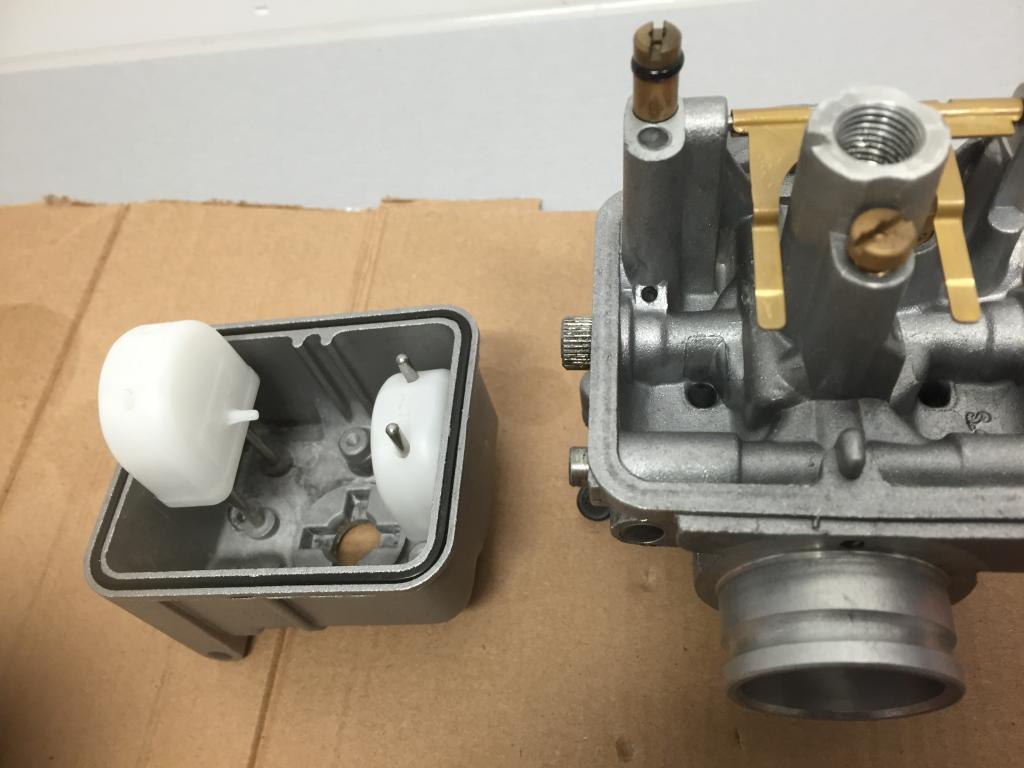

mariusj Posted February 17, 2016 Author Report Share Posted February 17, 2016 (edited) Im almost positive that its fuel, the oil smelled a lot like it. And i was not grey/milky. I have taken of my carb to do some cleaning and try to replace the needle. There is to "floaters?" in it, one of them is going up and down just fine and the other is kinda stuck. If i put it up side down only one of them come out, the other i need to take out manually. I guess this isn't right. So i guess the "needles" is bent? can i try to bend them so it also goes freely? Se the picture Edited February 17, 2016 by mariusj Quote Link to comment Share on other sites More sharing options...
crazybond700 Posted February 17, 2016 Report Share Posted February 17, 2016 (edited) That is not right, should move freely.But if that explains your problem, if it sits on top the carburator would not get enough fuel since it ''thinks'' its full enough. The other part which could be bad is the needle which is situated behind the big threaded tube on the right of the picture. Edited February 17, 2016 by crazybond700 Quote Link to comment Share on other sites More sharing options...
